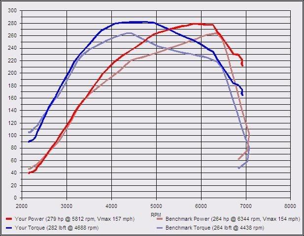

Originally Posted by Lancerguy'03
im getting Kevinized today......
and the results:
big improvements in the mid range torque. hope you like it andrew!

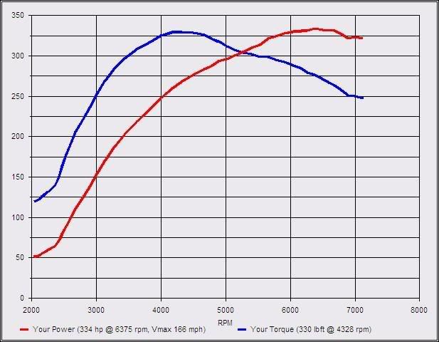

Originally Posted by nikkadanny
i wanna see my results
got those too. unfortunately your "before" results were messed up. it started at 3000 rpm instead of 2 like usual, and it was saying 280ftlb of torque and 380hp... which we know isn't right. anyway, here are the after results:
