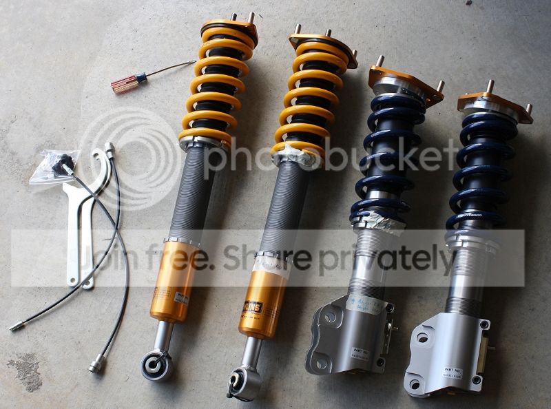

After ordering, a few days later everything arrived. CBRD had assembled and pre-set the Ohlins in height. I'd rate my mechanical ability at a 6/10, and had no problem at all doing this on my garage floor, because it was cake as they assembled to the right height and set preload. They were also kind enough to label everything. I needed the help from my wife for a few seconds to put a nut on the rear shocks from the trunk to secure them, but it's an easy solo job other than that.
Unboxed. Height adjusted, preload set, setup, and shipped by CBRD.

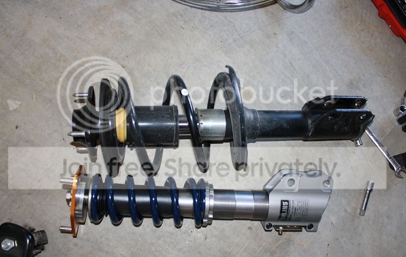

Front suspension comparison shot.

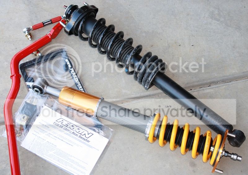

Rear suspension comparison shot.

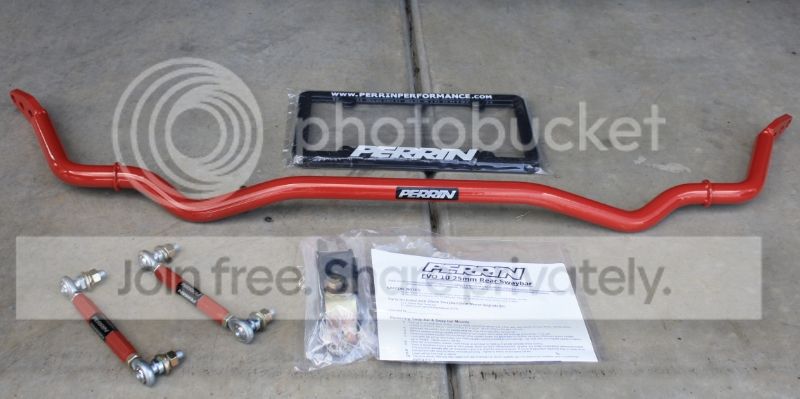

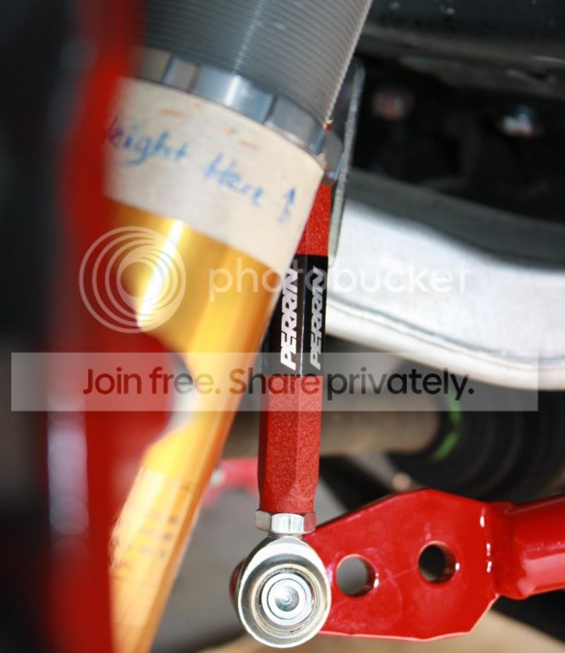

The swaybar was pretty easy, make sure you follow the directions of setting the endlinks up to mirror the stock setup, and that you do install them with the back wheels still off, as it will allow much easier access to that top endlink bolt.
Perrin rear swaybar and endlinks.
Perrin parts installed.
