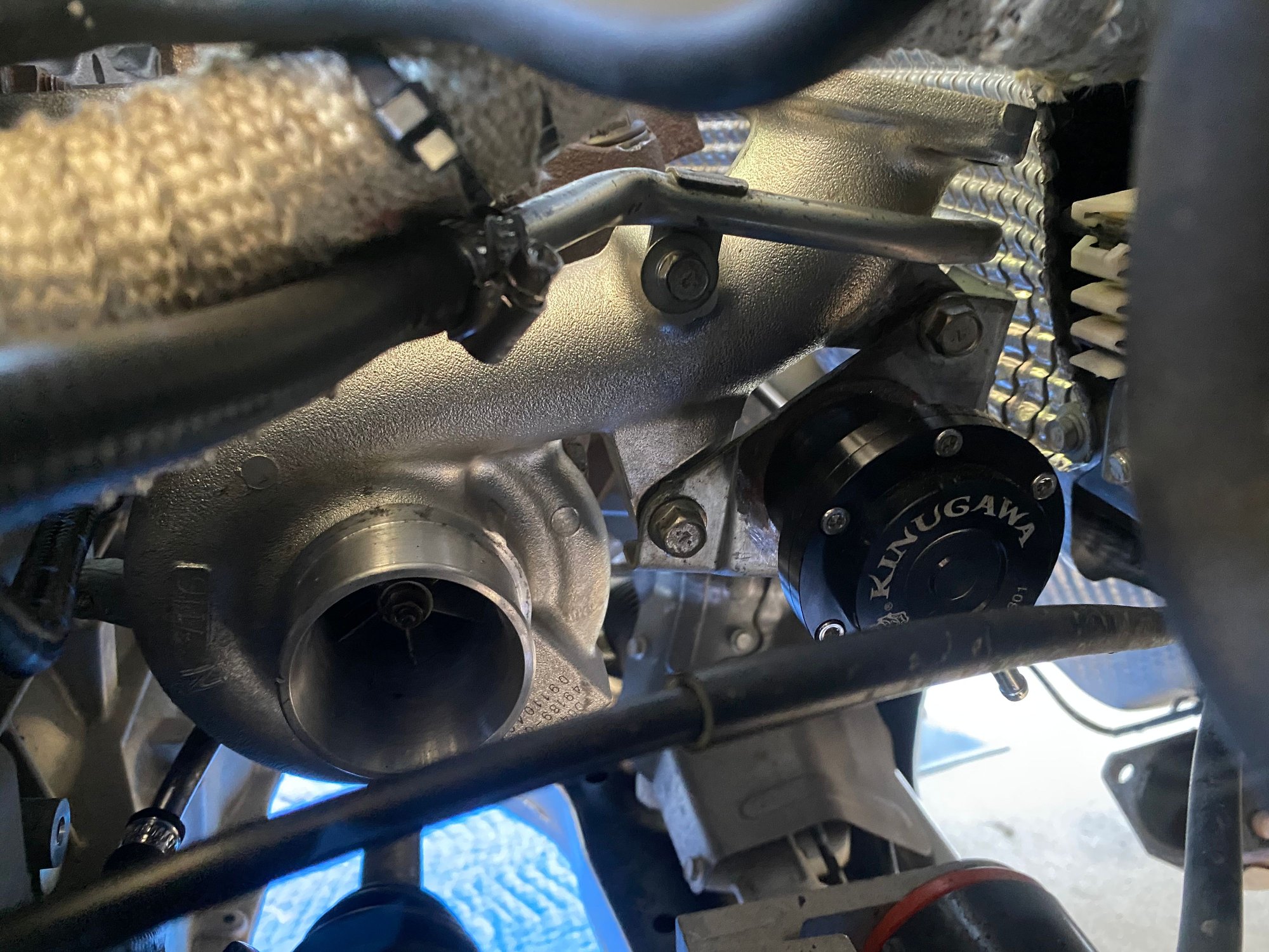

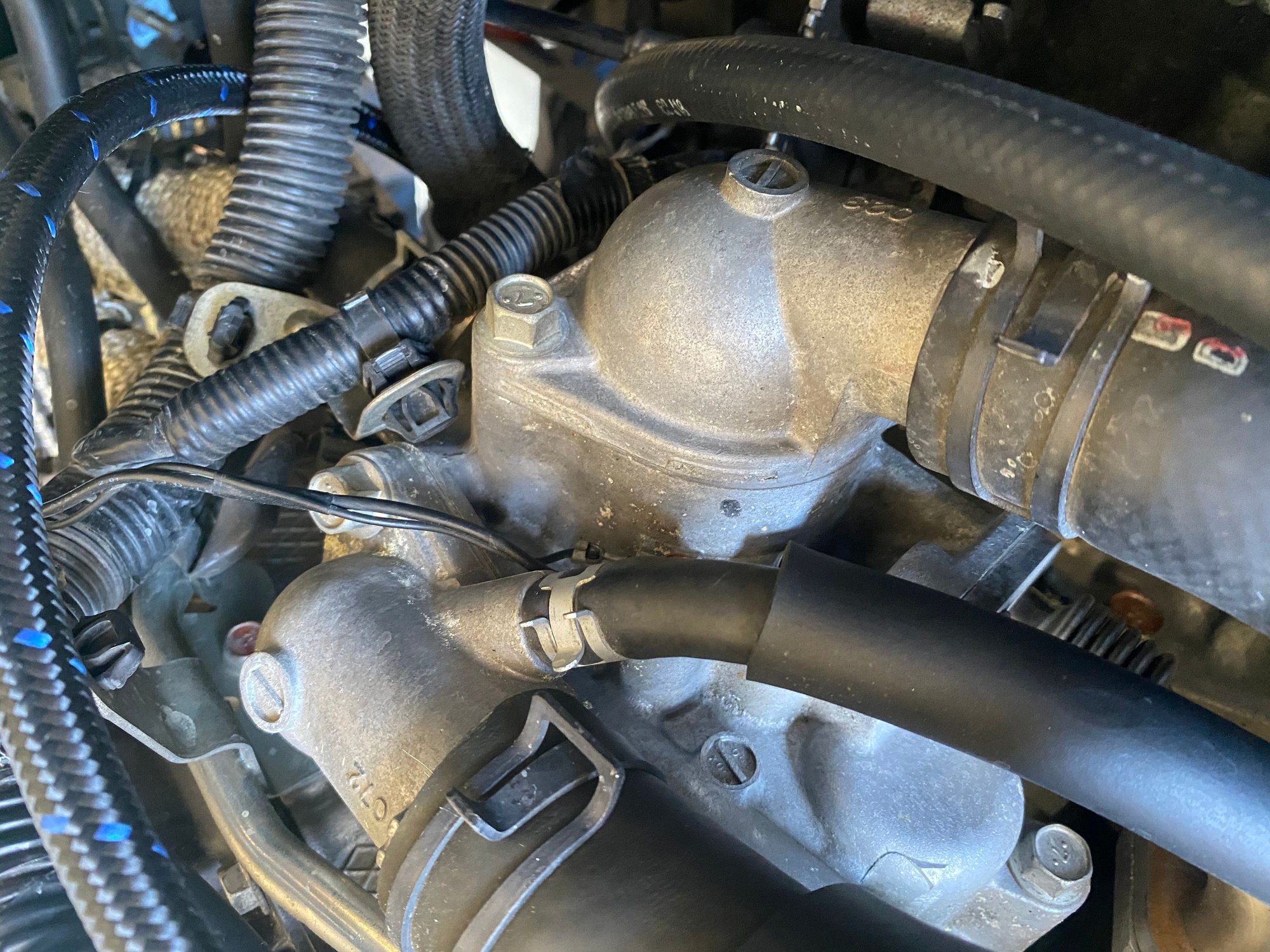

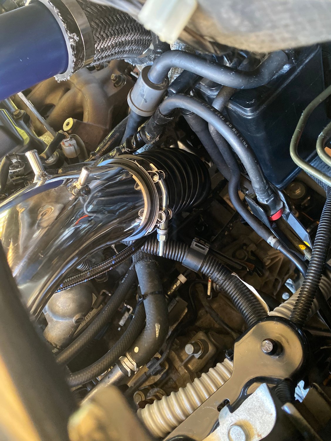

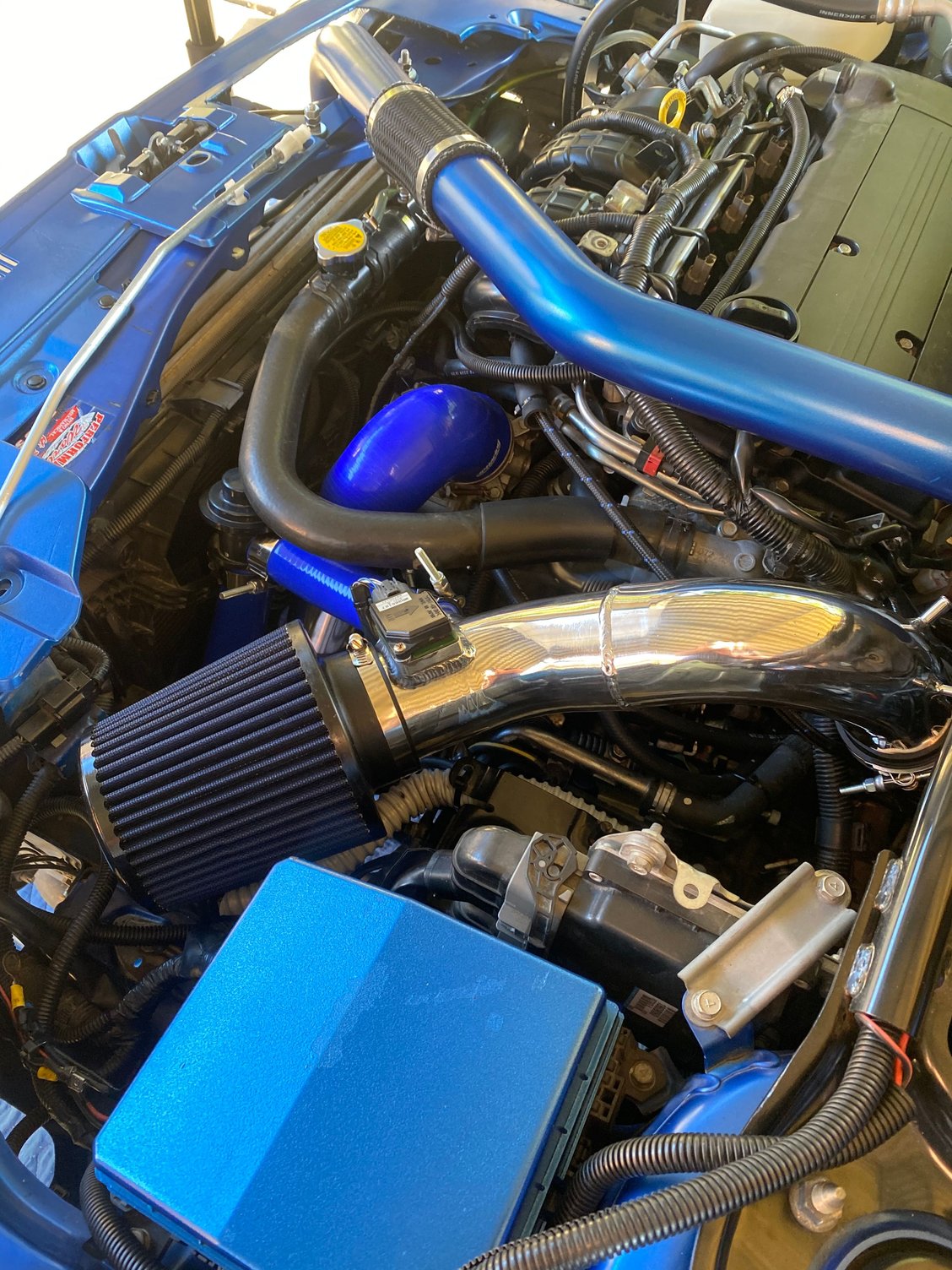

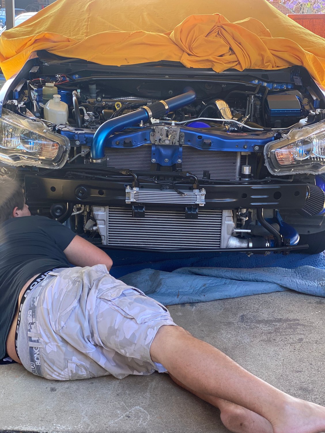

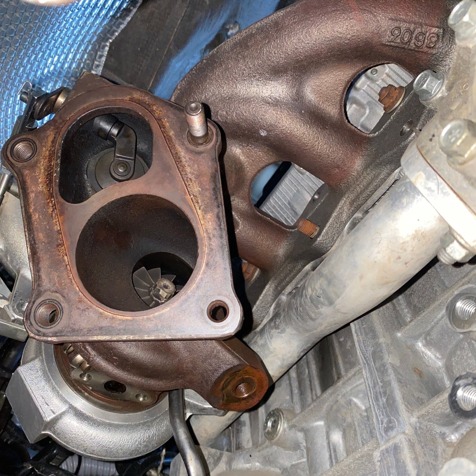

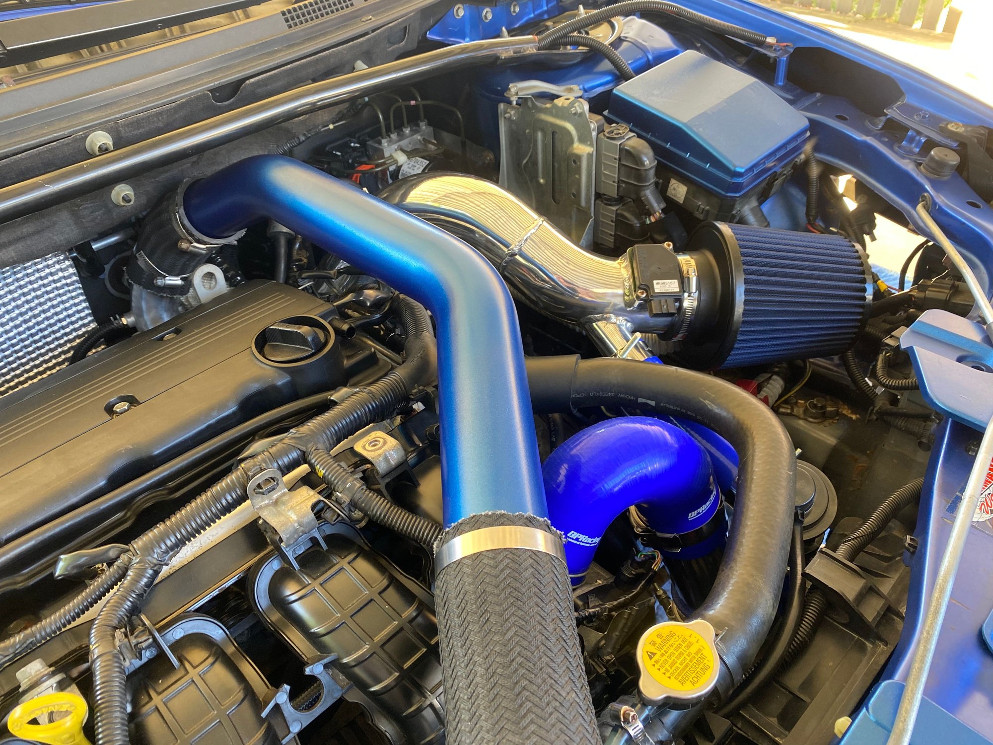

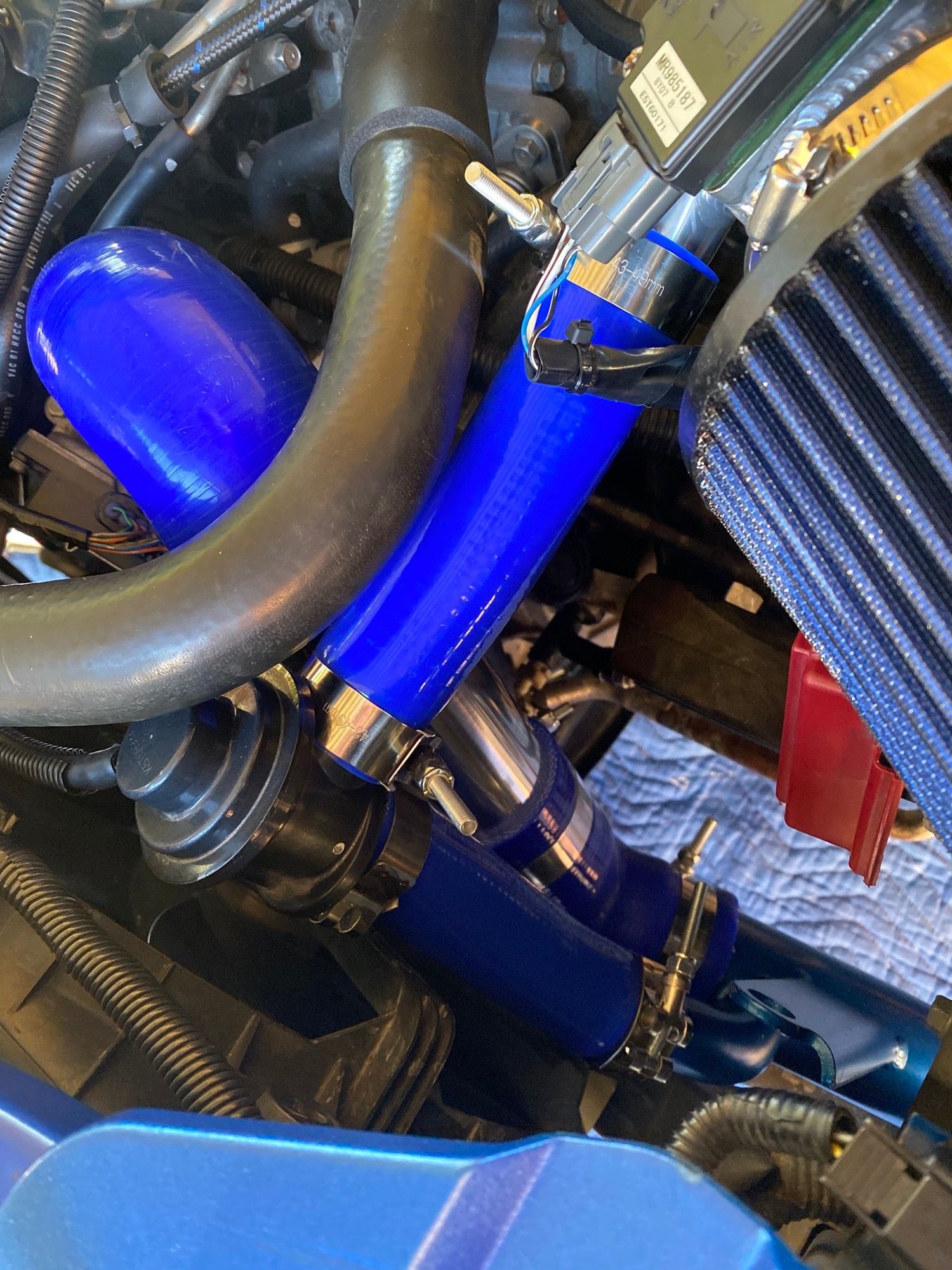

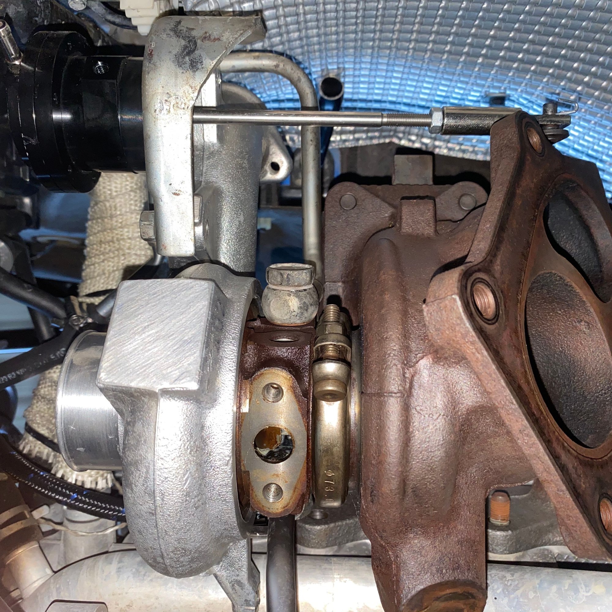

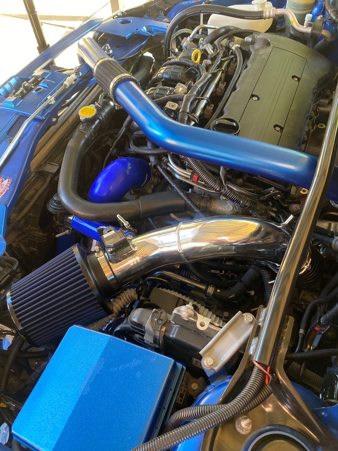

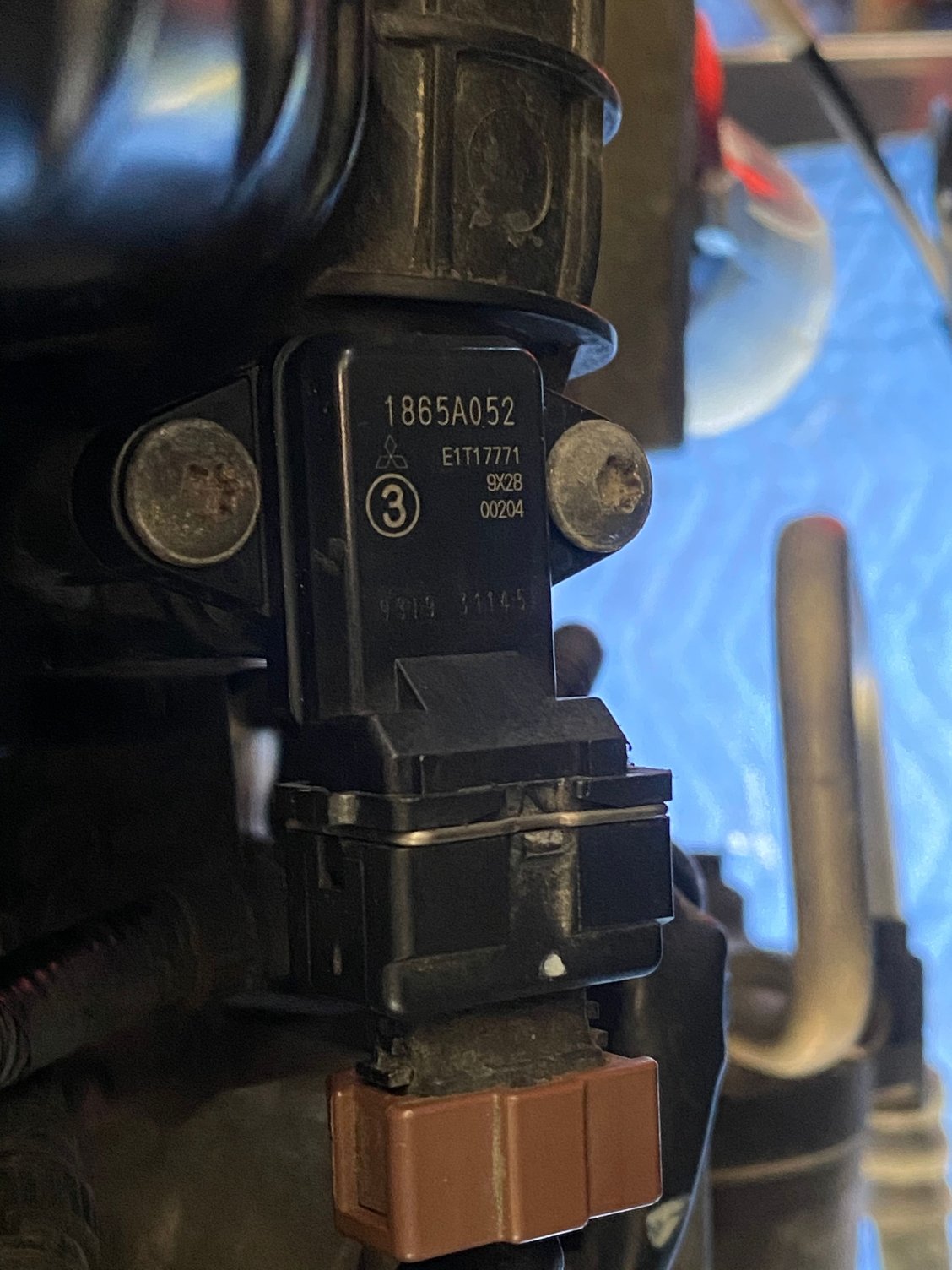

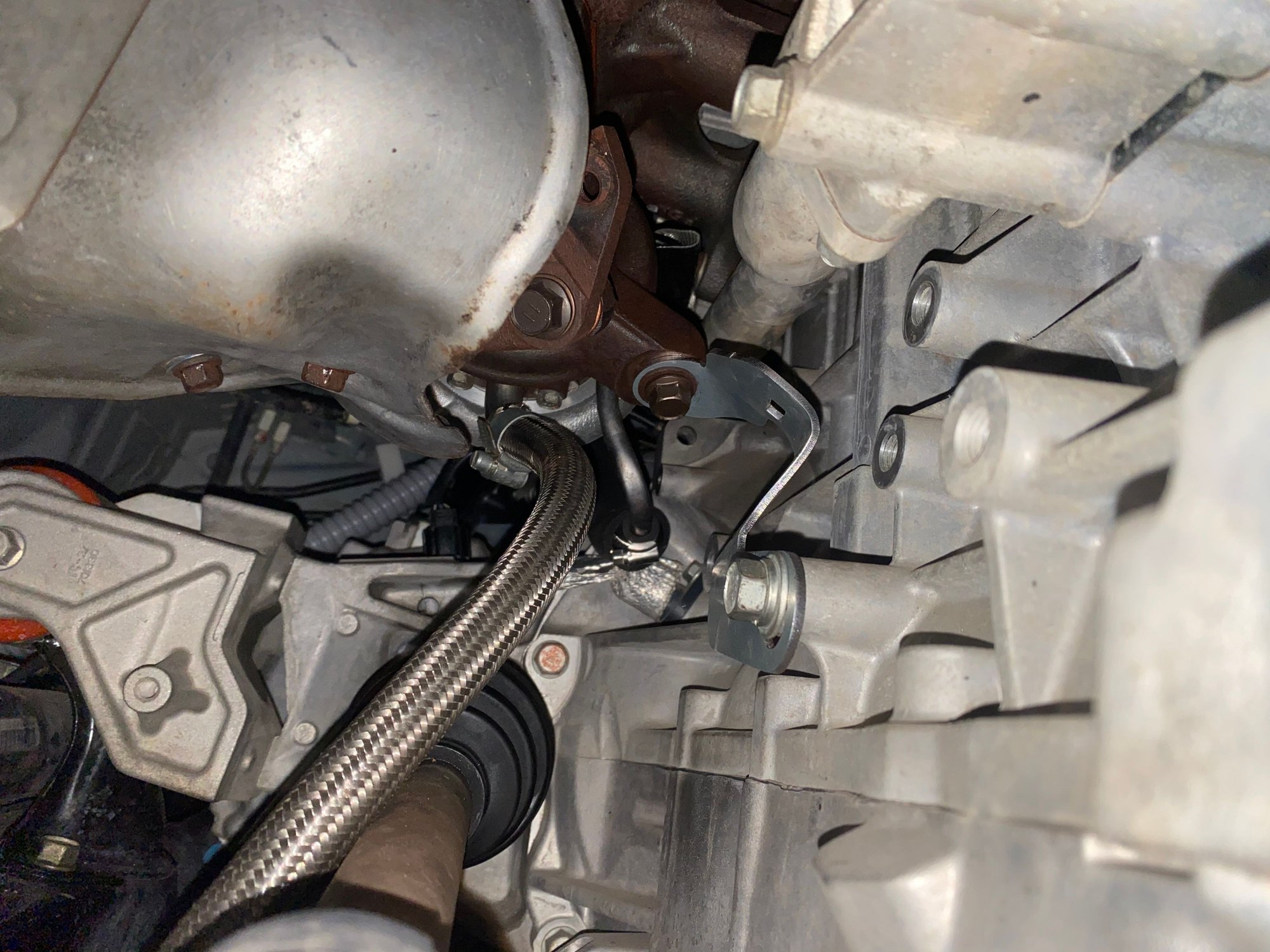

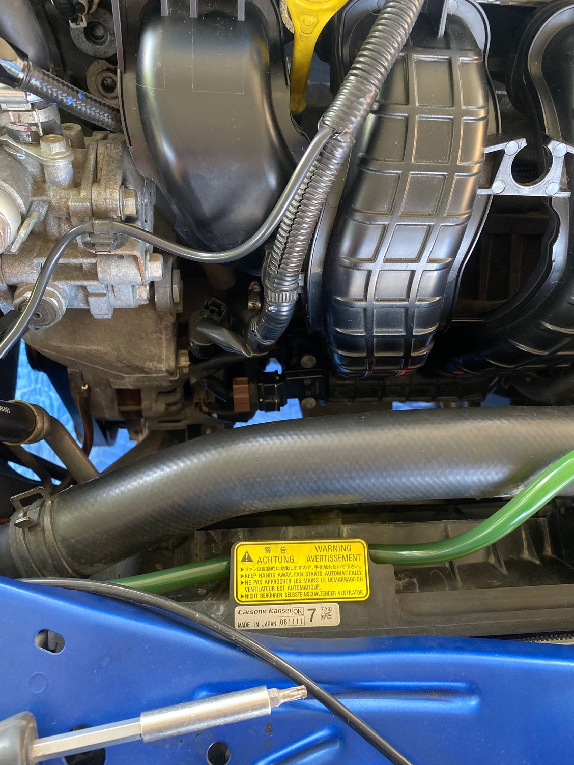

I’m starting this tread so it can be of some information to this year model lancer I have successfully done the conversion heat are the pictures I took along the way

Hey man, I have been gathering parts to boost my 2008 lancer 2.4 and I saw that you're from Australia and got excited as I have reached out to a few people about tuning my car and I haven't has much luck. I just wanted to know where you got your tune from and how much boost you are running?

I had a company in Brisbane Queensland AK Racing they are online as well they benched my ecu with a rom/map from an evo 10 GSR manual I have a pink kinugawa 0.6 bar spring in my actuator my set up is only on gate pressure no boost control I have it adjusted 15 nut turns from we’re it just slips on to the waste gate I have had the car on the road with this base evo 10 map/rom for about 3 years now and I have had no issues apart from running a lil to rich the car backfires on 98 octane but I have mainly used 95
I haven’t had a dyno tune yet lol I probably should but the clutch is starting to get weak now I will be replacing it then I might get a dyno tune hit me up on Facebook “Gfys GC” man I’ll be happy to help you out with your build
