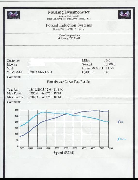

Sure... Xede with WORKS 3" DP, HF CAT, IP and ABM (Axle Back Muffler).

What does the mustang dyno read in comparison to the DD? I see 293, but I don't know how to evaluate that. Was it on 93 octane?

Yes, 93. I know there is a conversion factor, but not what it is. On the day this dyno run was done, another car with similar mods made about the same. So, this is representative of a Stage Zero+ on a Mustang Dyno, I think.

That would be me. I have a megan racing down pipe, stock cat, custom 3" catback and an XEDE.
I laid down 291.6 @ 7000 RPM & 282.1 @ 4750.
The difference between lowkey's car and mine is the HF Cat. His torque shows up earlier. Otherwise our graphs are nearly identical.

you can figure a 10-12% higher read out on a mustang compared to a dyno dynamics. basically take your DD number and multiply by 1.10-1.12 and that'll give you your number. for DD to dynojet it's about 12-15% higher.
my DD at 12% (260x1.12=291.2) is almost identical to the mustang numbers listed above.

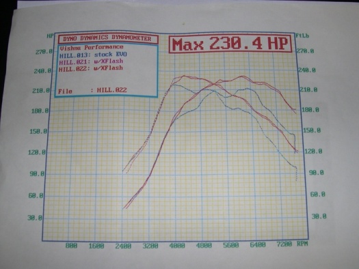

Just xflash no mods baseline was at 210 on 91oct
also clip
also clip
click me
Yea, your running stronger than normal. I think Shiv says the baselines do like 190-200whp. Good results. I think I was probably around 220whp with just Xflash.
