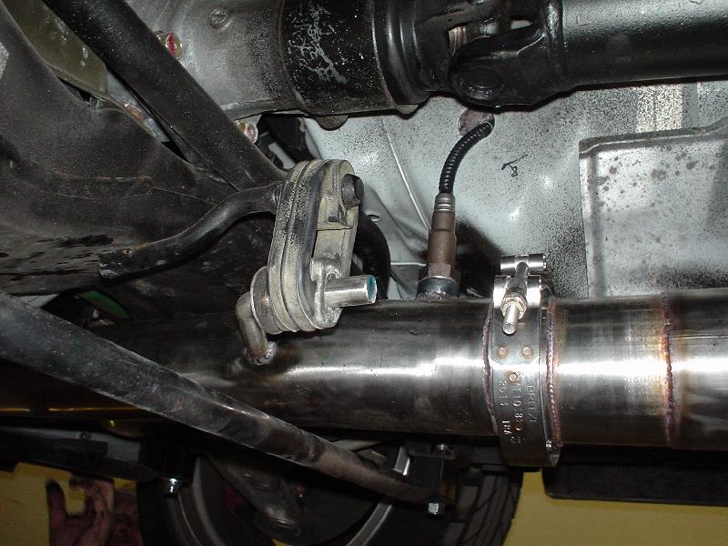

Here's a link to a pic of my signature DP.
https://www.evolutionm.net/forums/at...chmentid=37535

Thanks for the pic Ludikraut. Mine sits a lot lower than that and I don't know why....
Anyone else has more pics of the DP near the flex joint?

I would not recommend using the attachment point to the transfer case. Mine sheared off the pipe from torque. It was welded back on, and tore off again and wore a hole in the downpipe (replaced under warranty). I would recommend grinding it off (check with Vishnu, I am sure that they are aware of the issue).
SF
