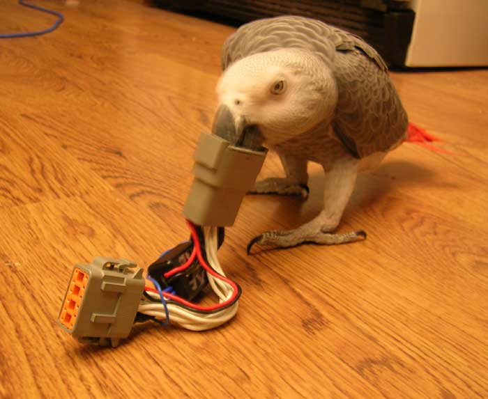

Cons: Instructions still need some work, Parrot stole PnP harness, firmware updating difficult for those with new laptops

Somewhere at the Vishnu shop is a parrot with a plug and play harness and I'm saying that little bugger needs to be shot out of whatever tree he's in to get that harness back.
That thing that Omid was playing with was a voltage converter for the Miata XEDE. The plug-in SMART harness is something that we'll be working on during the holidays when we have some more free time on our hands.
Thanks for the review!! Glad you like it

Originally Posted by shiv@vishnu
Hi guys,
In order to ease the work involved in installing the SMART fuel and timing upgrades, we're going to produce a plug-in harness that plugs into your XEDE harness (between your XEDE's grey connector and the Grey connector on the harness). This plug-in plug-in harnesses will already come pre-wired for the wideband and knock buffer. The only thing you will have to do is to source the wideband's 12v power from the cig lighter.
We did just this for a 12v->5v voltage converter that we use in Miata and Porsche XEDE applications (pic below). It used to require a signficant bit of wire cutting, splicing, etc,. But now it takes 3-4 seconds
We just ordered the parts earlier today and will whip up some Plug-in SMART harnesses as soon as they arrive. Just a heads up for those who are about to start the install but don't get along well with strippers (of wire, that is) and solding irons.
Cheers,
shiv
I guess it was in fact a Miata. But what's the hold up? Is it lack of electrical connectors...
