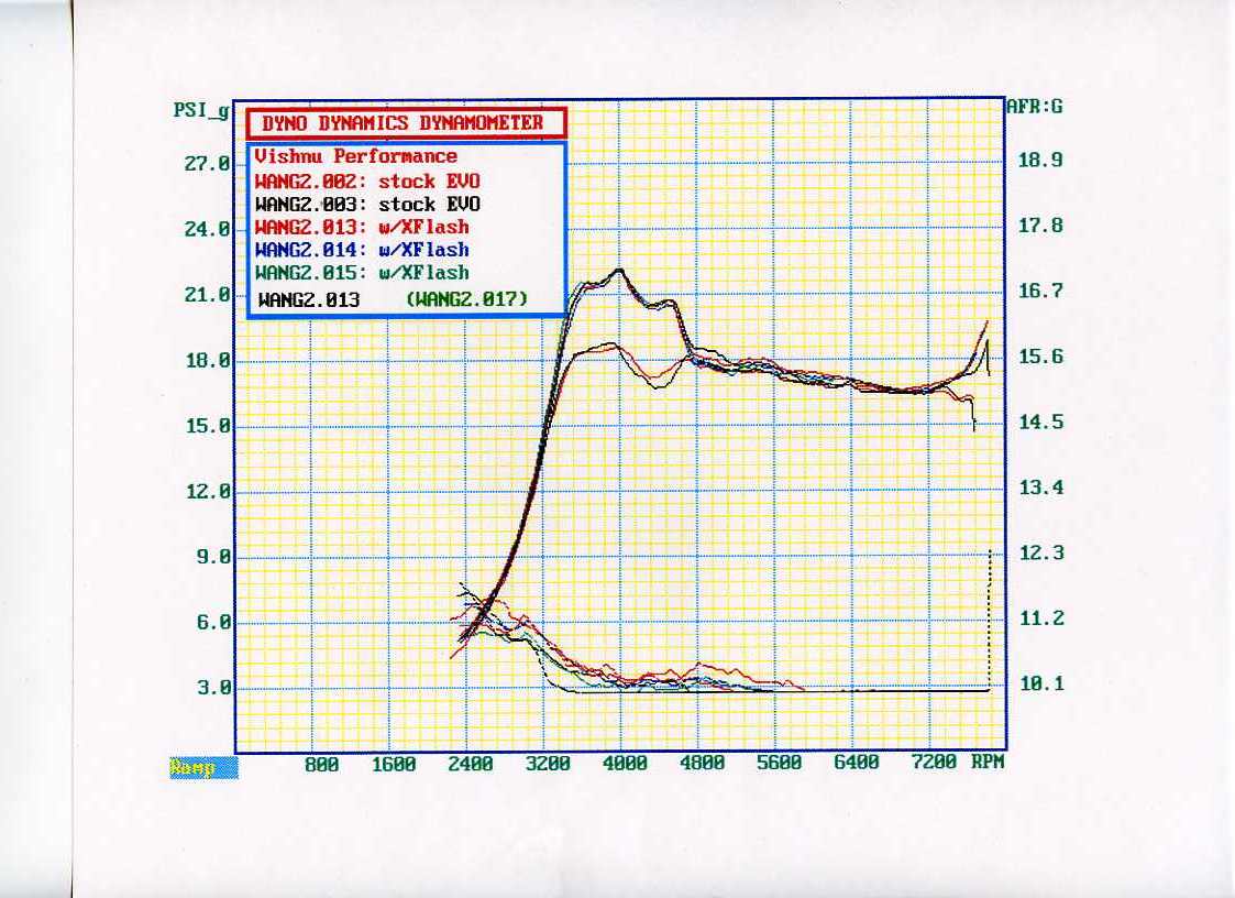

Boost and AFR:

Is boost pill removed on the Xflash? It spikes high and settles back down to stock levels..seems to change most from 3200-4700rpm

Yes, the pill is removed. We also install a little fitting in that same line. This gives us the ability to reduce wastegate solenoid duty cycles while still being able to raise the boost in the midrange. FWIW, the stock ECU drives the factory solenoid to 90-98% duty cycle, making it impossible to raise boost substantially remapping alone.

Why are the A/F's still in the sub 10's? I could have sworn they were higher on the flashed cars?

Not on our flashed cars. On 91 octane, they need to be this rich for sufficient knock surpression. Running them leaner can result in a strong run or two. But repeatability and consistency go to the gutter. As does drivability as you can feel them pull timing from time to time on the road.

Also AFRs look very different between these two dyno runs. Is that due to the ability to alter the knock signal with the XEDE?

Your comparing an EVO with a full exhaust to a stock EVO. The stock EVO, all things equal, needs to run richer than the EVO with the exhaust for maximum power/safety margin. It also runs less boost up top due to exhaust gas restrictions.
Does no response to this question mean YES?
