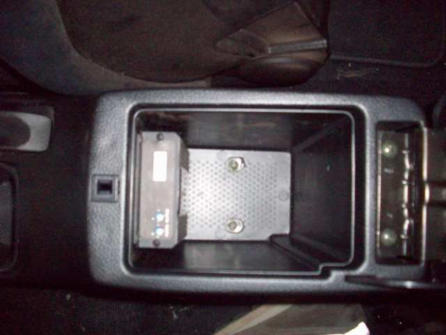

I installed my Snow performance meth kit w/ the 2.5 gal tank and low level indicator. Figured I would share. Let me know what you think.
Attached Thumbnails Snow Kit install-1-meth-kit.jpg   Snow Kit install-2-positioning-tank.jpg   Snow Kit install-3-putting-tank.jpg   Snow Kit install-4-running-lines-1.jpg   Snow Kit install-5-lines-finished.jpg

Still more! The light on the fuel gauge is the low level light. Activation light is on the A-pillar. Sorry for all the attachments, didn't know how else to post the pics.
Attached Thumbnails Snow Kit install-17-controller-installed.jpg   Snow Kit install-19-injection-nozzle.jpg   Snow Kit install-21-installed.jpg   Snow Kit install-25-light-installed.jpg   Snow Kit install-26-activation-light.jpg

how did you put that connector on the ic pipe like that? also youre running the meth without a tune, does it still perform i mean could i do it without a tune?
Old Aug 5, 2008 | 07:11 PM
bhood1's Avatar
Joined: Nov 2007
Posts: 102
From: KY
The Snow kit comes with a tap....you just drill and thread. I run denatured alky, the tune that i have on the car is VERY conservative.....with alky it just makes it run richer.
