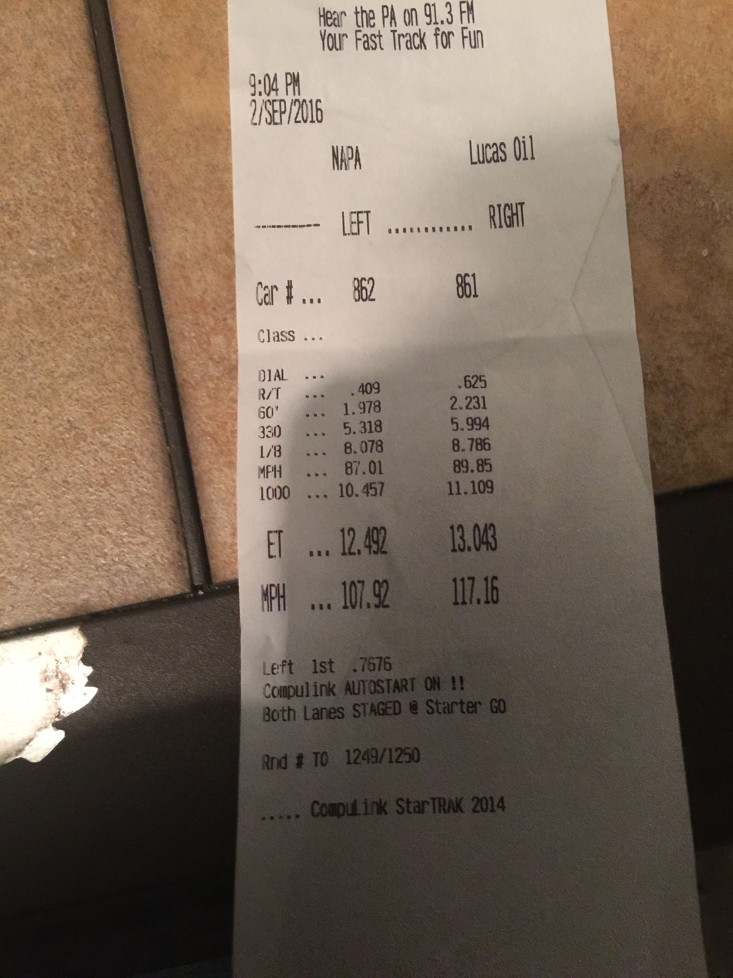

We removed the back half of the exhaust and it felt a bit stronger according to the owner.
Slip posted here; ( There's definitely more in it. It was rich on higher gears)
#862 (No launch control was used either)
