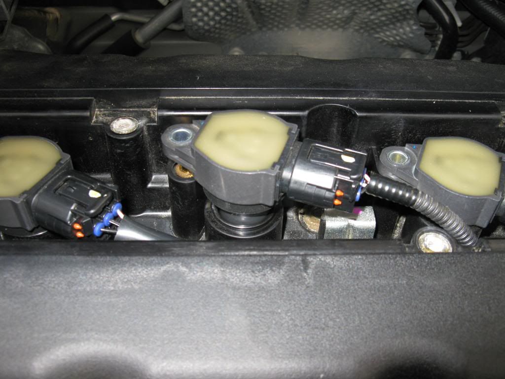

Step 2: Pop the hood and remove the spark plug cover to expose the ignition coils:
To remove the cover you could use either a Philips-head screw driver or a 10mm socket. Once the cover is off, use canned air or some shop towels to remove excess debris from around the ignition coils.
Step 3: Remove the ignition coils:
It's best to change the plugs one at a time so that you don't get the ignition wires confused and screw up the firing order. So pick a coil and use the 10mm socket to remove it. As you're pulling it out, you'll hear a suction cup sounding "pop". Gently unplug the coil wire harness, remove the ignition coil and set it aside in a clean place.
