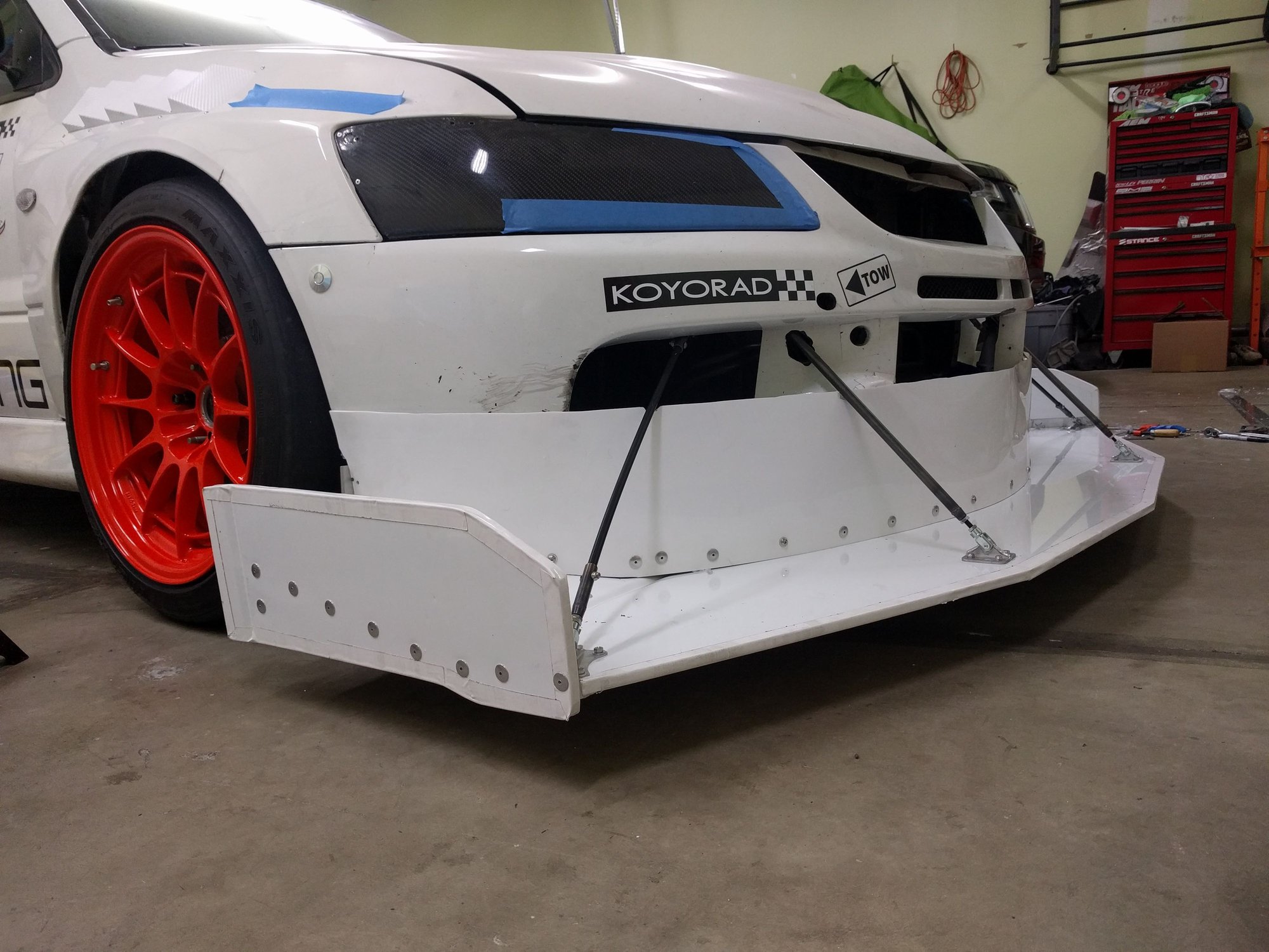

I spend sometime this winter with 10mm Alumalite and created a front splitter that hopefully will be more effective that my APR splitter.
The whole assemble weights in at 25 lbs, vs the APR one at 15lbs. Not as light as I wanted; however, I have high hopes that it will do well. The splitter was able to support me at 180 lbs. I had my wife stand on it because she is prettier than me.

Some nice DIY splitters here..I'm also looking to do a splitter like awdboosted except smaller using an apr cf splitter as the base and aluminium for the dam part...wel see how it turns out..my main reason for making one is regulate undercarriage airflow rather than front downforce. It will stick out 3-4" max.
