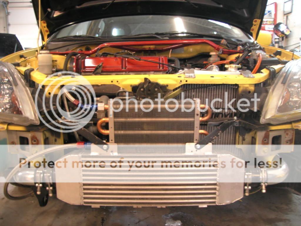

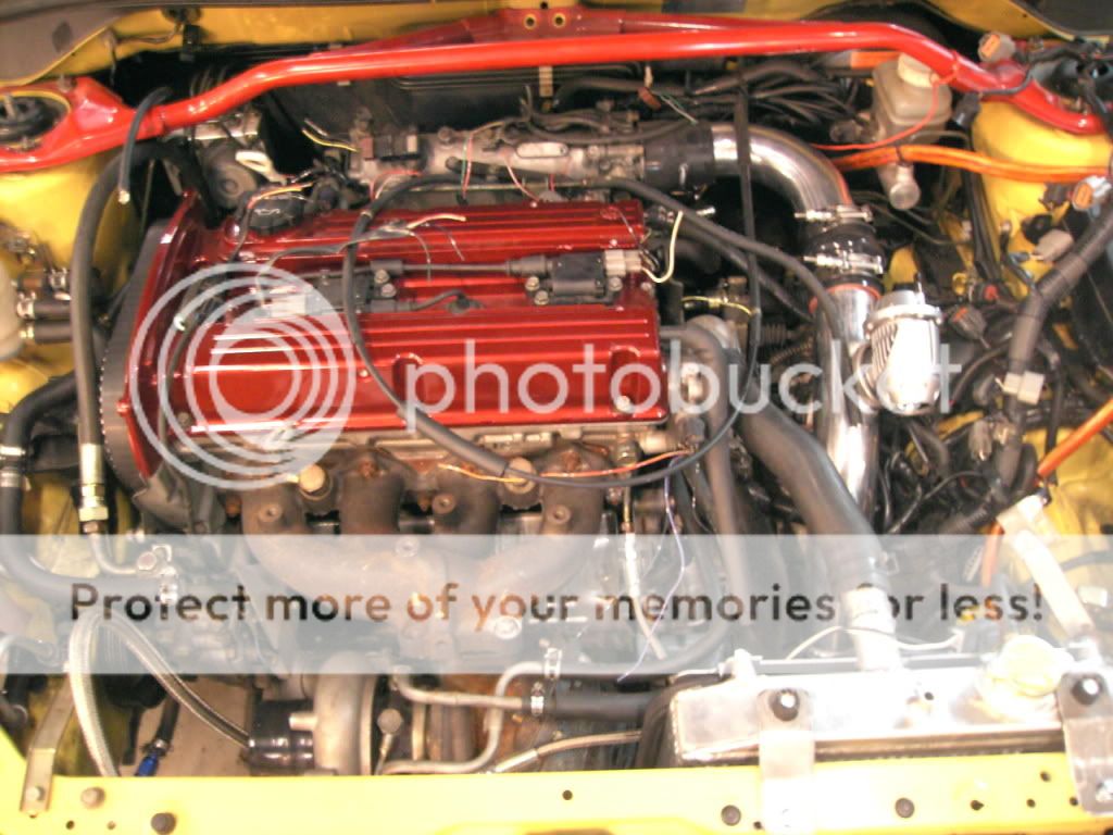

I am FWD with my 4G69 tranny but: ( in 1 month i have a full rebuilt of my transmission and Quaife fwd LSD + Cryo treated gears. Because i will put some mods on the evo engine ! the only shop where a goes avec a AWD dyno but we can just set on fwd, ou RwD mod !! heheh
Matt
Some pic!! starting projet!!

oil cooler?
Why is the turbo the opposite direction of every evo/16g'd lancer I've seen?

That BOV is loud.

GOod Question, i try to fit all normaly but the 2.4L transmission Starter was there and bloc me a little bit, so that easier way to but the turbo was the turbo hot side ! hehe =D

More pics with better camera please.
Well done, I'm impressed. Did you have to do anything to the trans to bolt it up, such as a new bellhousing, different clutch assembly, etc?
