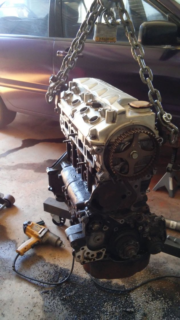

Thanks to bakuro117 for the internals! Got the engine out yesterday (i work 7 days a week at the moment so time is limited) teardown will begin this week and hopefully I'll have the block and head ready for the machine shop by this weekend!

Little update, slowly getting it torn down. I only get to work on it between 1am-3am, maybe I'll get lucky and get a weekend off. Doesn't happan often, the life of being a machinist lol.

Ringland failure cyl 4. Head is pitted pretty good, gonna snag a good head out of the junkyard and send this cam off for a regrind by Schneider Racing Cams. Cyl wall seems to be okay, no gouging or anything that catches the fingernail, block should be disassembled by this weekend and ready to go to the machine shop!

Typical failure for a RRM set up

Wow I can't believe you're still active on these forums! I enjoyed your build thread. I beat the hell out of this car and it had 186k on it, no idea how long it's been boosted but I've put 20k hard miles on it with this kit, i expected it to blow much sooner lol
