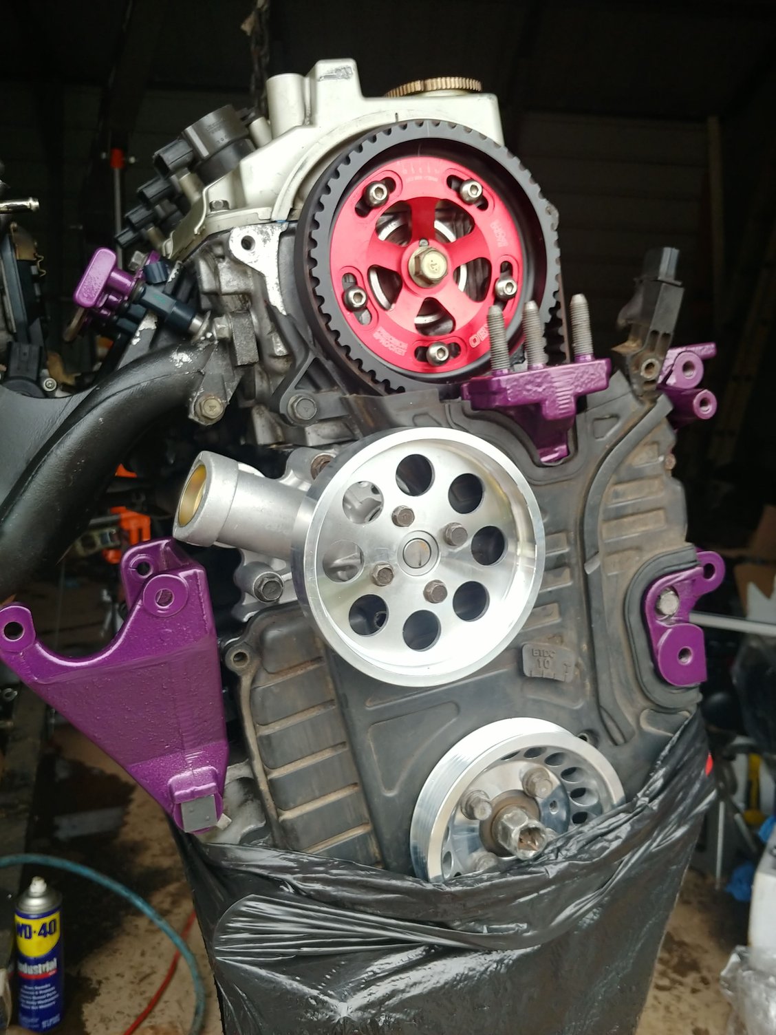

Woooooooo it's been quite a few months since an update. I bought a new car, and had a bad knee injury, wound up having to have surgery and was out of work for 2 months but none the less, the Ralliart build continues! Block is back from machine shop, installed the new Balance shaft bearings from the BS delete kit, visiting the in-laws for the weekend but eager to finish the bottom end assembly when I get back! Also, dropping my spare mock up engine into the car while waiting for my rebuild head to be shipped back, and dropping the car off at my buddies shop for him to fab up my manifold, downpipe, and wastegate dump the week after next, so hopefully by the end of December I've got the complete engine sitting in the car, and waiting to be tuned! Hope everyone has a great Thanksgiving!

It only took 2 years, but the engine build was completed! I DID get a custom cam ground for it. From Gaby Racing Performance in PR! Car is still not completely finished, although I do have everything needed aside from clutch/injectors/standalone. Engine is in the car and just sitting until I have it dropped off at a local fab shop for the manifold to be finished. Just a lot of $$ to get it done and my C7 has taken most of that haha. But an update none the less!
