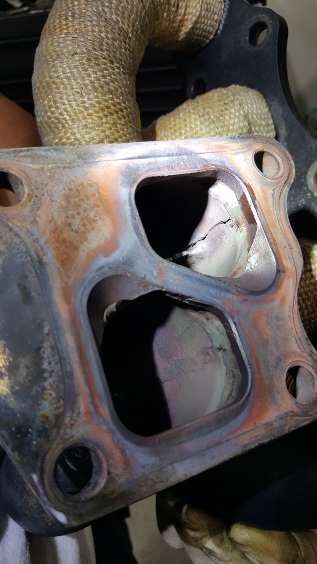

So, heres the scenario...exiting the highway about a month ago I downshift and give it some gas and the car just bogs down and starts cutting fuel. If I hit any boost or even give it 50% throttle it limps. I get back to the shop and see that my MAP turbo manifold has cracked in several places.
I take it off and get it rewelded. I was told the heat wrap is more than likely the culprit in regards to the cracking. I end up getting a heat blanket for the rewelded manifold. I reinstall everything and the car is still giving me issues.
I scan the car with the Launch CRP123 and get P0171 and P0141. I replaced my o2 sensor just for good measure and clean the MAF and MAP. Then, all of a sudden yesterday morning I find a P0219 and P0171 sitting on the scantool that wasn't there before. I check and don't see any misfiring issues or anything else that looks out of the norm. I compression tested the car and yielded results of 140/140/135/135 and a vacuum pressure test sat right around 17 in. Hg. The car is still having the same symptoms, at first start the idle is around 1200, once it warms up it drops to around 900rpms, which is normal. My vacuum gauge in the car jumps between 18-20psi at idle, like it would before the issues. If I try and drive it with about 25% throttle it seems to run fine/normal but the minute I give it about 50% throttle or hit any kind of boost, the car bogs out like it's cutting fuel. Edit - I am also now getting the infamous starter noise when I crank it up...not sure if it could be adding to the issues or not...
I guess my main thought at this point is, could we have missed a crack in the manifold? If so, could that be causing the P0171 code and for the car to be going into limp mode or cutting fuel? Could the turbo have blown? Could the crack in the manifold have caused other issues that I am overlooking?
I still have my stock manifold and an extra stock turbo. I can put either on and see if it helps but was wondering if there were any other things I should test before having to take the manifold off, yet again lol.

with cracks that bad theres no way your turbo is working like it should. your tune may be calling for 7psi at 2300 rpm so add X amount of fuel but the problem is your turbo is not winding up correctly thus throwing all the expected parameters off. car sees issues throws itself into limp mode. i would put the stock manifold back on ASAP to avoid other issues. all other things aside spewing white hot exhaust gases into your engine bay is bad news

The manifold has been rewelded and reinstalled...yet, it's still giving me issues. I am going to swap back to the stock one tomorrow. I am building a boost leak tester, also. I'll do both tomorrow and see what happens.

i would do the boost leak test like you mentioned. There is a SMALL chance when the crack in your manifold formed it splintered metal and a piece could have damaged your turbo. if your boost leak test does not turn anything up than the next thing would be to slap that space back on. do you have an AFR gauge?

whoa those are some hellacious cracks.
Yeah they are lol

Those are bad cracks... I vote for do boost leak test first.
