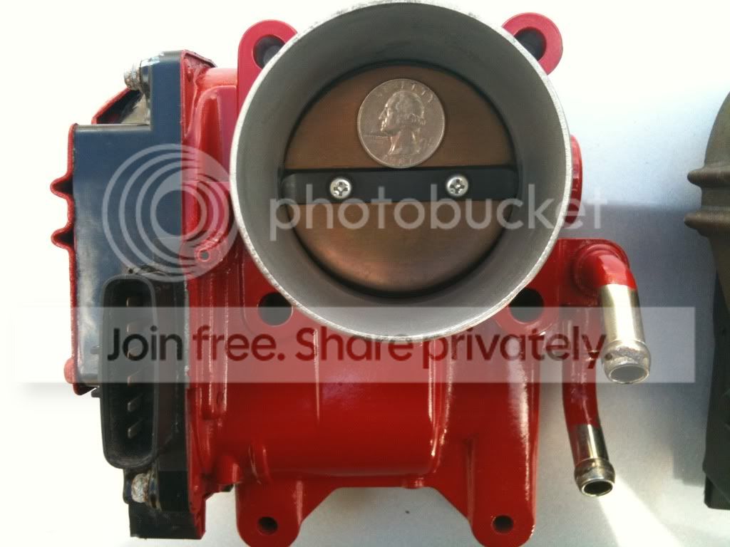

Ok so I found this one for sale its from the Endeavor...but it looks different than ours/GT's So how would this bolt up?

And darewood that will bolt up, they aren't showing you the whole thing in that pic. There are 2 more holes up top. I'll post up a pic....

Here's a pic of mine from a 2008 gt eclipse, I painted it red to match my rrm intake manifold
and here's a pic of the old stocker from my 2005 ralliart

omg thank you! I'm going to get this now Well I'm going to try and make an offer first haha. And I will be painting mine as well I have my intake and engine painted red. Also my interior dash is painted red. Red on grey=sex
