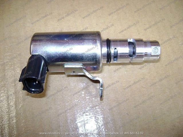

Please help, I'm trying to find a replacement for the 'Mivec valve controller' or 'oil feeder valve' or 'oil control valve', whatever you may call it I need a new one, Mitsubishi part number mn137240. My timing belt went while I was driving and when disassembling my cylinder head I noticed the OCV was kind of hanging/dangling, upon looking at it more I realized it was broken, I thought nothing of it figuring it was an easy fix. Why does this part have to be so hard to find outside of Mitsubishi itself? Any help would be appreciated, thanks

it's a pretty important piece of kit, and it's unlikely you'll find an aftermarket replacement...

I've learned it's importance, but not looking for aftermarket just maybe one from a wrecked car or something. I believe the dealership is priced at $400-$500 hoping to find one maybe half or hopefully less than that

It's $270 here:
http://oemmitsubishiparts.com/parts/...&siteid=214331

Thanks Lanzer that would be great.
Also thank you RA that's super helpful. I can't wait to get my car back on the road
