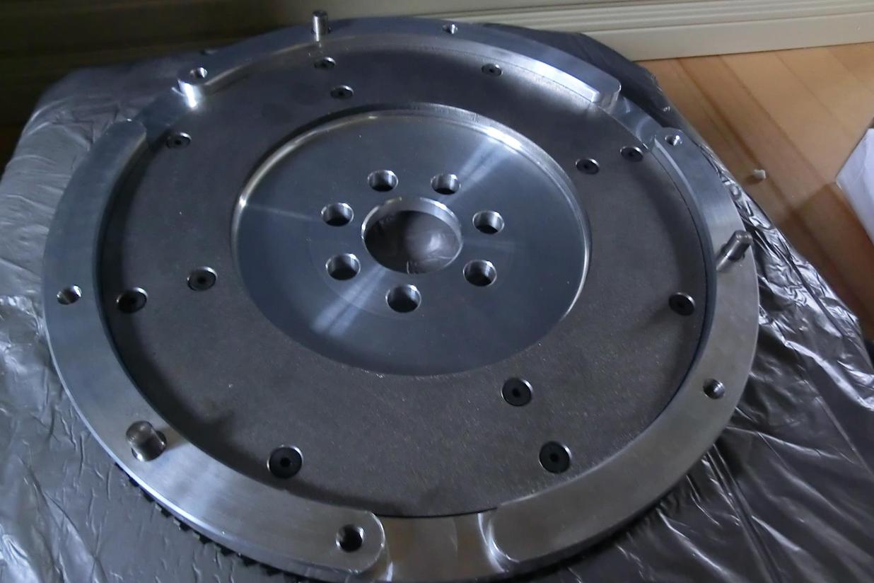

I don't know the right words in english but its because the hub of the clutchmaster is tinier and is .. I really don't know how to tell so here the pics. lol.
First pic its the fidanza wich you see is flat ! and then the clutch master is different.. the word I can't get !
Pics 2-4 is CM and 1-3 Fidanza...
Was so happy when my mech dropped the clutch over the bolts and BANG it fit (I had left my clutch alone at the garage so I couldnt try it sooner..)
Attached Thumbnails flywheel PROBLEMS-10733025_580487648745930_30290518_o.jpg   flywheel PROBLEMS-10718755_580487892079239_2076364378_o.jpg   flywheel PROBLEMS-10718105_580487735412588_550821241_o.jpg   flywheel PROBLEMS-10682573_580487938745901_1876035177_o.jpg
