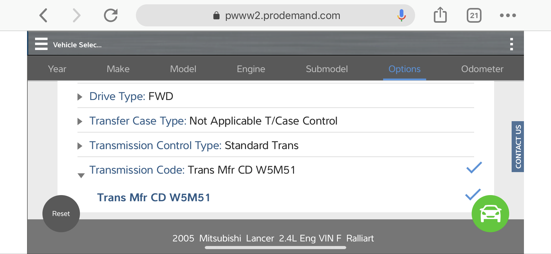

I have access to pro demand which is a program that garages uses and schools that teach automotive technicians for the ralliart lancers with the 4G69(2.4L) the transmission code it gives me is W1M51 and the one in my Oz ralley 2.0L has the F5M42. I’m in the process in doing an engine swap and I’m running into the issue with the bellhousing being different. The motor I’m taking out is out of a auto so I don’t know if the bellhousing from that will work. But yah I searched this up a lot and I’ve found out that the ralliarts have the W1M51 and when I was looking for gears and stuff the transmission shop asked me which one I had knowing the year of my vehicle. And I’m from Canada so same as us.

Either your information is incorrect...or the Mitsubishi factory service manual is incorrect...to my knowledge, all manual gearbox lancers from 02-06 used F5M42 gearboxes, and the only difference is one is a -1 and one is -2

Im not 100% either but the two different codes would make sense for the bell housing to be different but everything that google says it’s the evolution transmission and nothing about the Ralliart. If that’s the case it being the F5M42 then things should go a bit easier for me in a swap I’m doing lol
