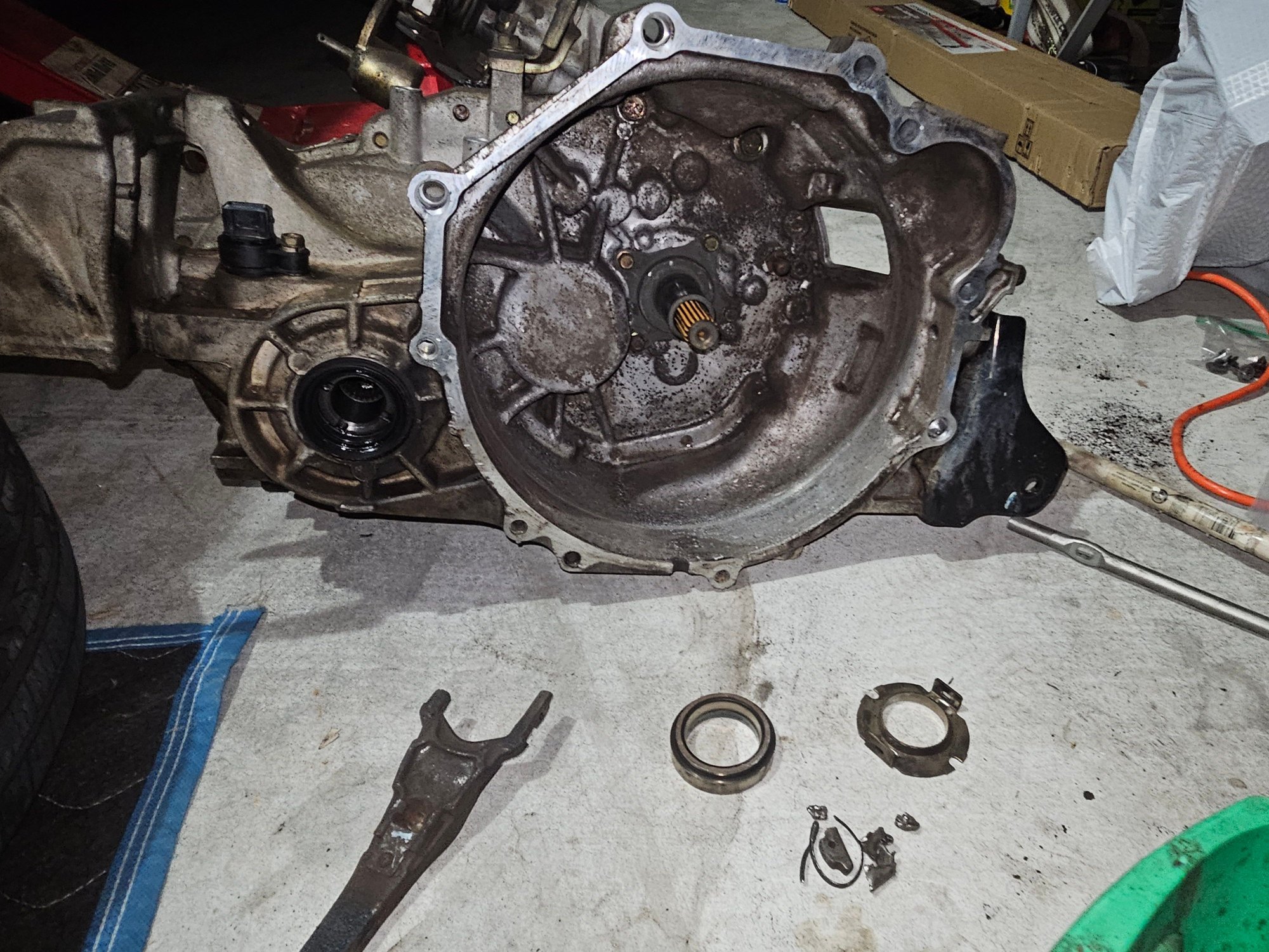

Just took out my transmission to replace clutch and throw out bearing but the bearing messed alot of stuff up. I want to make sure im not skipping any part needed. I have a new fork, fulcrum part is good, and release bearing. Is all that I need the clip? Am I missing anything else? If anybody has a part number id
This is what came out of it
appreciate it.

Mitsubishi OEM Clutch Release Springs for Evo 4-9 Upper MD749672 $1.76
Mitsubishi OEM Clutch Release Springs for Evo 4-9 Lower MD749673 $1.76
Mitsubishi OEM Clutch Release Fork Shaft Seal for Evo 8/9 MD749474 2X $2.82
Mitsubishi OEM Transmission Case Seal Cap for Evo 8/9 MF665535 $1.30
Mitsubishi Clutch Fork Bushing - Evo 8/9 MR953913 2X $13.98
