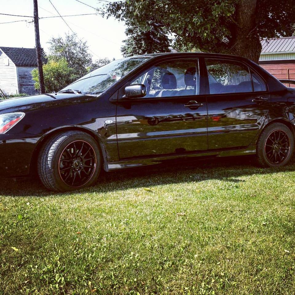

Eh, Just finally got myself a 05 Lance ralliart, and I'am loving it. What can you guys tell me that a newb to the Ralliart community should know. I know it has one issue. Its a valve you can see when you take the oil cap is off. It ticks and the guy told me its an easy fix.'
ve read up on it that it is.
My new pride and joy.
