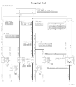

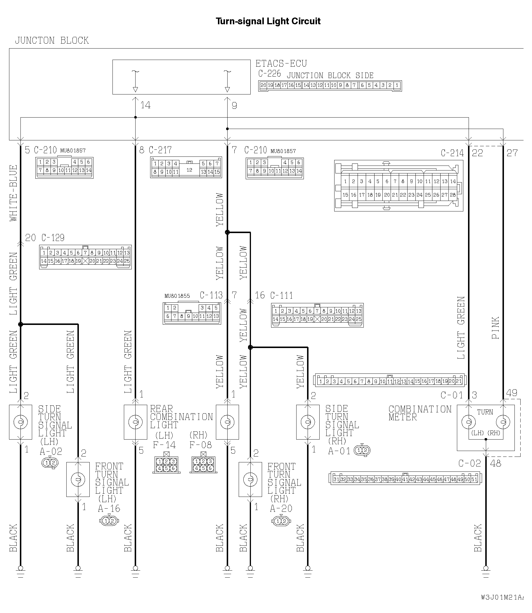

How much power do they draw? Incadescent bulbs or LEDs? If it's LEDs and the power draw is low, you might be able to tie it in to the side blinkers without popping fuses. Otherwise you might have to find a way to tie it in to the flasher.
Actually, it looks like we don't have a flasher, but the blinking is controlled by the ECU. Here's a diagram if it helps you any.

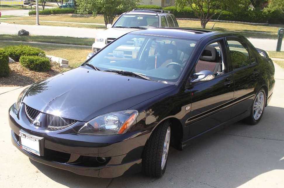

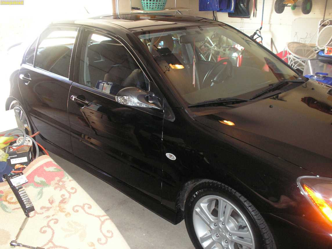

Here is the Install.
I didn't wire up the mirrors because I changed my mind and decided to wire it to the fender blinkers. The problem is I don't know how to get to those...any ideas?
