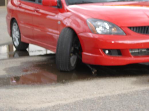

ok , first of all , check your wheels ...... if it looks like this .... i know what your problem is ahahahahhh (i was driving the other day when i saw this parked so i took a picture...) HORRIBLE !!!!!

I would really like to know the story behind that. If that's going to be a common problem with these cars, I want to know about it before it happens to me in the middle of a canyon carving run.
