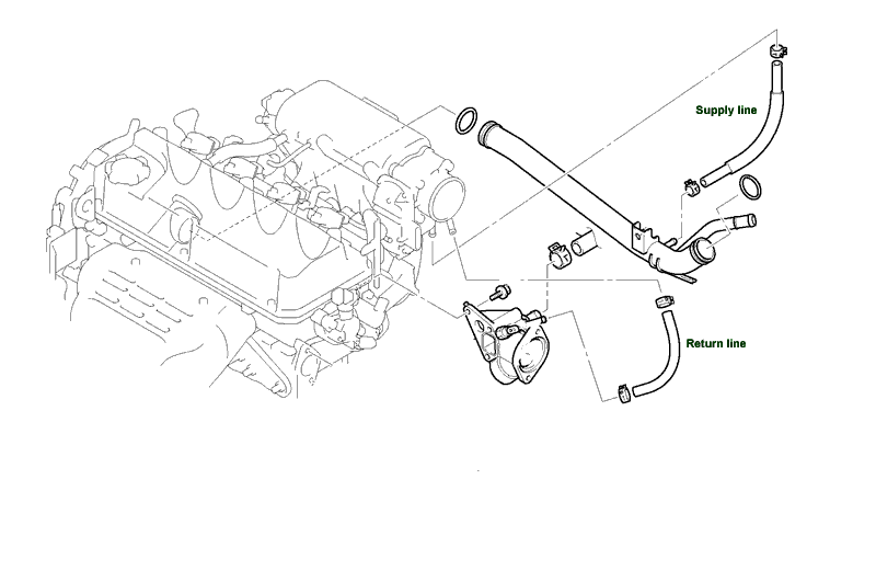

I've just recently installed the p&p IM and had that little heating problem it got fixed, then the next night i went to the track to test it, but only made two runs (everything went fine ) the next morning (today) the car felt when starting like it had no power to turn on and while driving, it made some pulls like when you take off the clutch fast when changing gears, then i got back to my house. later on wanted to turn it on it wouldn't, i got the battery check and it was the battery it was putting out 4.2 volts got it change and it turn on nicely, then I when to pick up my girlfriend and it made that same pull but less weaker and when is at idle it wants to turn off like if it had cam shaft and it turned off a couple of times i had to hit the gas to keep it at high rpms, that got me worried maybe it could be something me and my friend put wrong don't know
The only change I made is that hose trick the supply line that goes to the throttle i put it directly to where the return line goes in the thermostat, please correct me if im doing something wrong this is my daily driving
Any one had the same problem or similar that can help?

Why would you swap the supply and return line on the throttle body?
Old Mar 20, 2007 | 06:25 PM
qlitv's Avatar
Joined: May 2005
Posts: 200
From: Puerto Rico
Yes, that was the only hose trick
I didn't swap them I took off the return line and put the supply where the return line used to be (on the thermostat) so hot water wouldn't pass trough the throttle that heats the air coming in. To complete the cycle with out the water passing through the throttle.
If i'm wrong then correct me.
