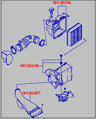

Anyway I was unfortunate enough to suck up water through my cold-air intake and did not have a by-pass valve. To make matters worse my dad threw away my stock intake when he cleaned up the shed. Anyway I've been searching for a stock intake and have not been able to find one. If anyone could help with the part number so that I can order it and finally get my car fixed it would be greatly appreciated. I posted in the appropriate forum however no one replied and I'm in need of help. Thanks in advance if someone can do this for me, if you have one for sale it would be even better.

Part # for the stock intake would be awsome. I've been trying to find out the # myself with no luck. I broke mine when i was taking it off. Don't ask me how but the part were the MAF Sensor go's I broke it off taking out the screws. I want to get a new one just incase I have to take my CAI off for some reason.

Here are the part numbers.

Awsome thanks alot for the Pic and part #'s. Much Appreciated!
