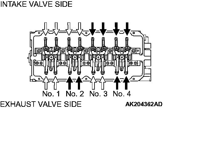

Set 1 or 4 which ever is on compression and then 360 you only have to turn it once. If #1 is on compression do the white valves if #4 is on compression do the black valves.

If i remember right #1 and 3 are companion cyclinders and 2 and 4 are. I won't say don't worry about the # 2 and 3 cyclinders, but when #1 or #4 is at TDC the easiest way to know what to adjust is to jiggly the rockers and the rockers that don't have the cam lobe applying pressure to open them or closing them are the ones that you adjust. Then rotate the crank 1 full rotation and do the same thing as previous.
