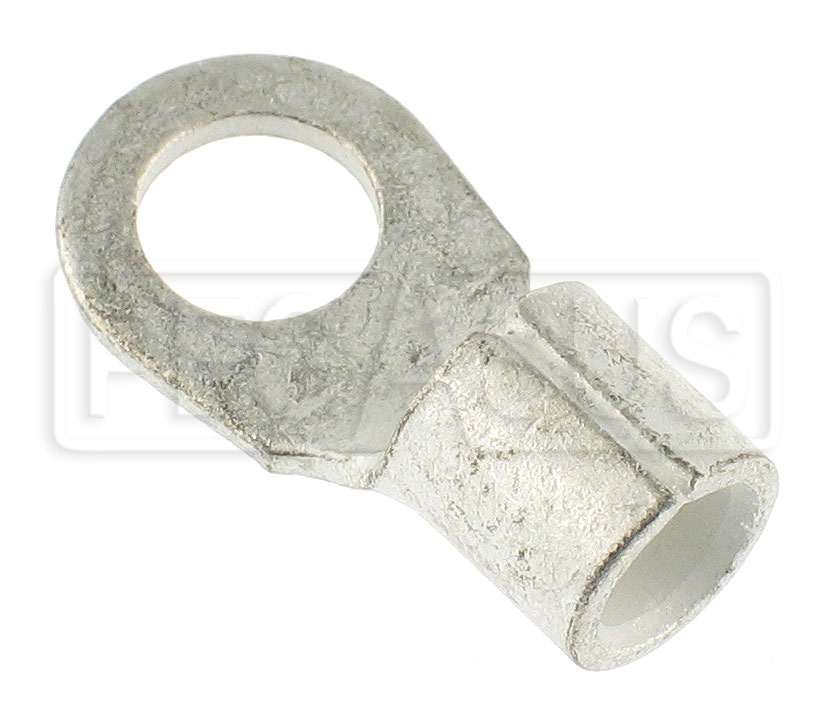

yes you're right i'm sorry i forgot lol!!! well i used a normal plier
like this one... you just need to press the terminal to keep the wire in place...

this is the terminal... u just press on both sides to clamp the wire... remember to peel off the plastic of the wire so it makes good contact with the terminal.--...
