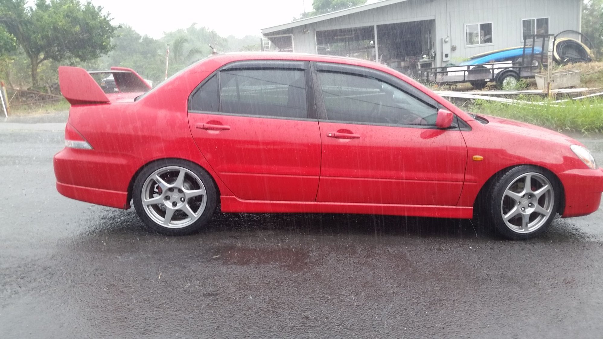

I drive an OZ Rally and my configuration (aftermarket brakes/suspension) results in a slightly different setup to that of a stock 04-06 Ralliart, but based on comparing a setup I had (205/50/16 16x7 +43mm) which was relatively roomy, a 225/40/17 or 215/45/17 setup is equivalent in overall size to what I had. With the +30mm offset, you may need spacers. 17x8.5 +30mm leaves 5.5" inches of backspacing. I had a Wilwood Big Brake Kit and 5.5" would not have been enough to clear the calipers, but with stock calipers it probably would have been fine.
This is my car from some time ago when I was running 205/50/16 and 16x7 +43mm wheels. You can see there's a good amount of wheel gap. (Not aggressive at all, but gives you a reference)
