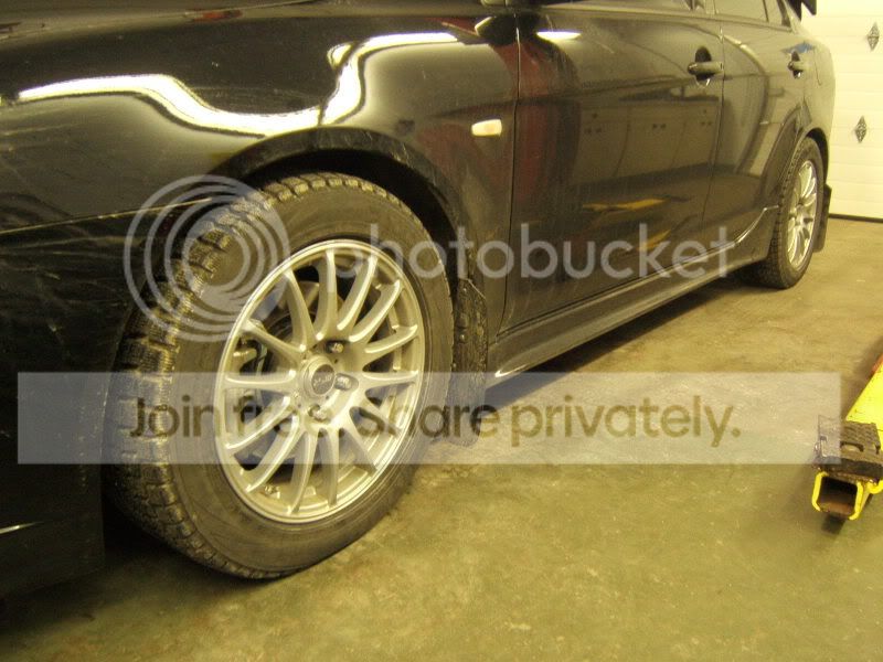

I installed the T1R lowering springs designed for the Lancer 08+ and they fit just fine! however the drop might be a little more than I wanted. Measured from stock front at 27.5 inch front and 27inch rear. Springs installed; Front 25.75inch and Rear 26inch
Therefore totaling front 1.75 inch drop
Rear 1.00 inch drop
I expect a little settling to happen over the next short while so it may be just a tad more. For reference I have 16in winters and there is still a 1.5 finger gap on the fender now. T1R states 1.2 inch drop on the 08+ lancer

Stock height
T1R Lowered Height
The Height has already settled a little more than that on my drive home tonight. It is LOW now.

It is pretty low but I had a successful day today not hitting the ground anywhere I put on about 70miles with hwy and city parking and driving. I rechecked today and its about a 2 finger gap on front and 1.5 finger on the back. this is with 16in rim with 60series 225.
It is pretty bouncy though. I will be investing in proper coilovers when available, that have the right valving in the shocks to control the stiffer spring. Still I"m pretty satisfied as it has really controlled the body roll compared to stock, When swaybars are availible I"ll add those too! But for right now, it looks really really nice!

but the spring rates are not matched, your struts will wear out quickly + the height, not the best in the winter
