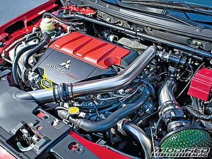

Look at the pic that I attached. It is of the Evo X engine bay. All cars that come from the factory with synthetic oil have a sticker just like that one so the techs know to put synthetic in when they change the oil if u forget to tell them. I haven't seen a RA with that sticker. Also I called my dealer before I did my break-in oil change to ask about price of oil change and they said that it was $35 for normal oil change but they suggested to pay the extra $ and switch to synthetic and they were baffled to why it didn't come from the factory with it.

2. YEP, no OEM oil sticker for RA at all...
