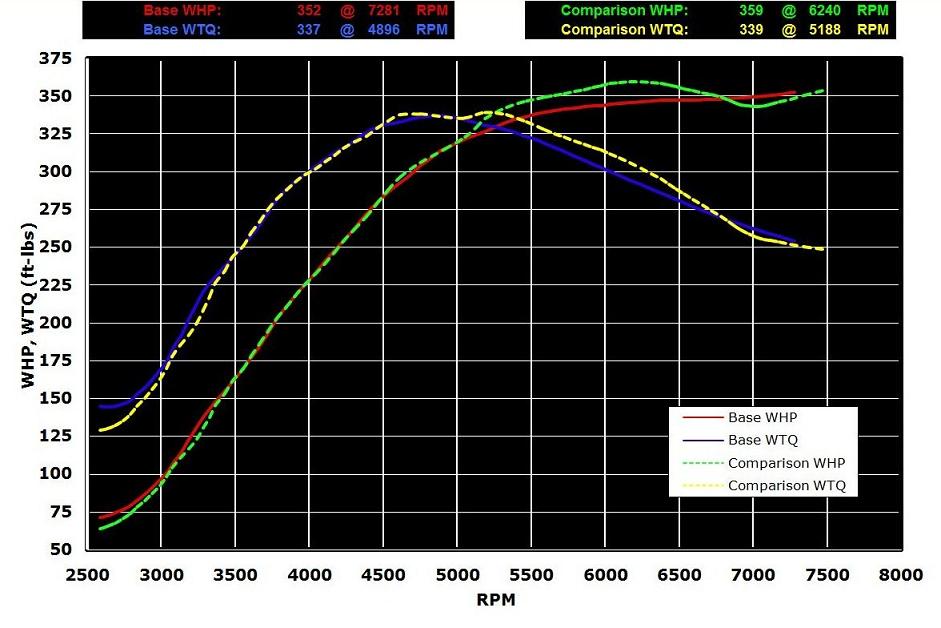

hey mate, i've tried Nulon Pro Strength octane boost and i'll definately say that it got rid of 2-5 counts of random knock and i was able to add about 3* up top now with the occasional 1 knock.
did a before/after log and charted it just to see any difference, its ruff example but hope this helps you!
Attached Thumbnails octane boost? Yes/no?-run1-vs-run2-w-nulon-pro-strenght.jpg

No, for the most part those off the shelf octane boosters make an almost insignificant change unless you use a lot of them. What part of Canada do you live in? Husky has 94 octane at most if not all its stations now.

i'd probably agree with you that most dont work, there are a few reviews out there with lab testing being conducted showing actual MON increases opposed to the advertised claims. personally i think they are expensive way to gain a little bit of power, better to mod and tune to whatever fuel is available. having said that, i was surprised at how well the Nulon worked!
