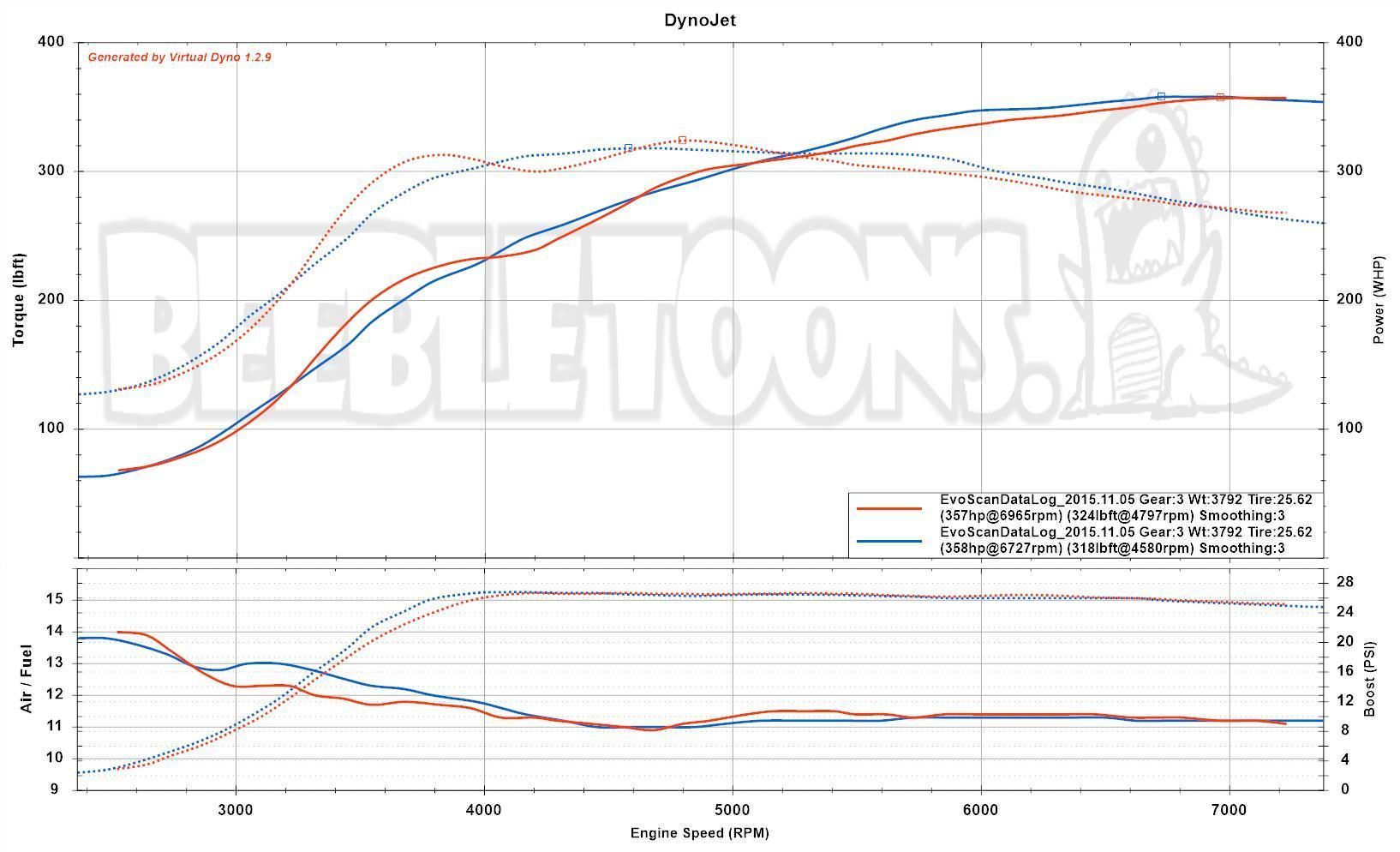

None of my business telling you how to go about your build, but just going off whats in my 2011 ralliart. I really enjoy having an MHI TF 06-18K Turbo build. Its basically made by mitsubishi and the guys at forced performance. Its a journal bearing turbo but I truly believe its the best bang for your buck. ExtremePsi sells them for like 1800 you might be able to catch it on sale from time to time as well for around 1600 on some websites. Anyway heres a picture of my virtual dyno for Adam Wade at beebletuning on a 80degree or so day at 4000' elevation on 91 pump gas (its all we have here). Just another viable option if your looking for some bolt on power.
