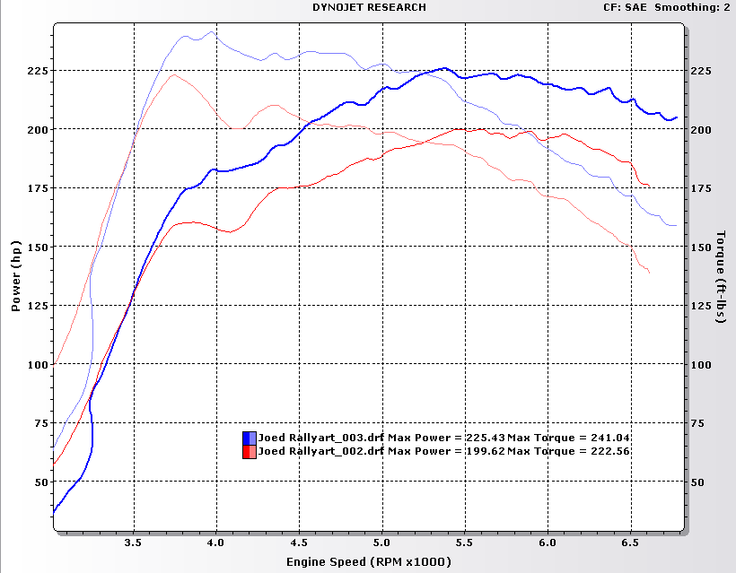

Member joedr put the GST BaseMap and boostpill on his 09 RA and had it dyno tested at the local dyno facility in Puerto Rico and here are the results:
Keep in mind this is the 91oct map using 93oct. I am working on a 93oct specific basemap currently for even more gains when using 93oct!
Red is stock map, blue is GST BaseMap with boostpill

Bryan, it's great to hear that you finally got what you needed to develop the 93 ocatane basemap. As soon as you post it I'm planning on buying a laptop, tactrix cable, and a GST upgraded boost pill assembly with boost hoses so that I can download your file and start running it. Thanks for all your hard work!
