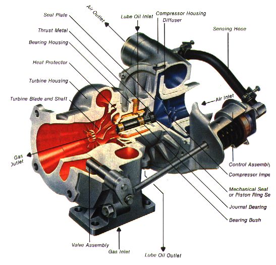

Not a pro. But that doesn't sound good, because the oil flows around the sealed inner bearing of the turbo. And if its leaking oil into the turbo housing that could lean toward some serious problems if its being fed into the motors (throttle body) intake. Once again not a pro but it might be likely.
Look.http://www.mkiv.com/buy_a_supra/turbopic.jpg
