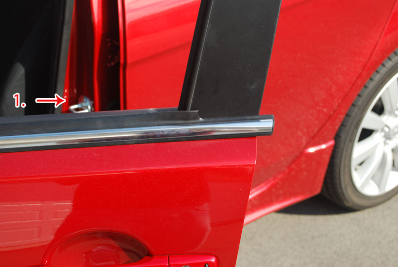

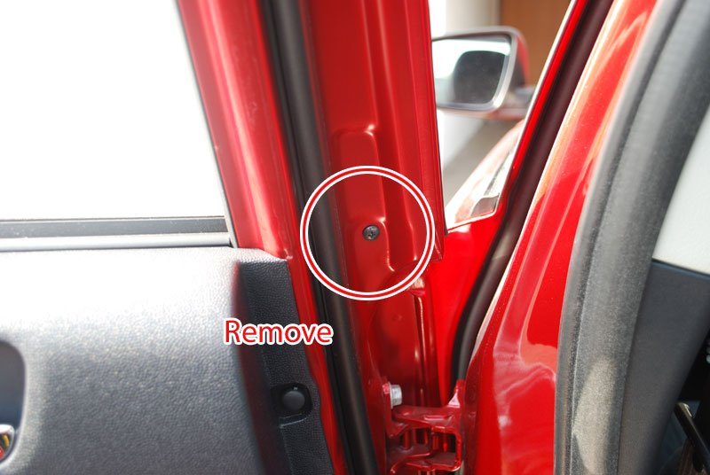

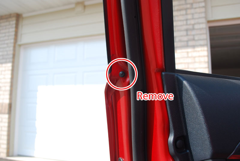

Sounds like there's a lot of people having trouble with this, so I pulled mine off and took pictures.
Step 1 - Remove screws
Front:
Rear:
Step 2 - Remove trim

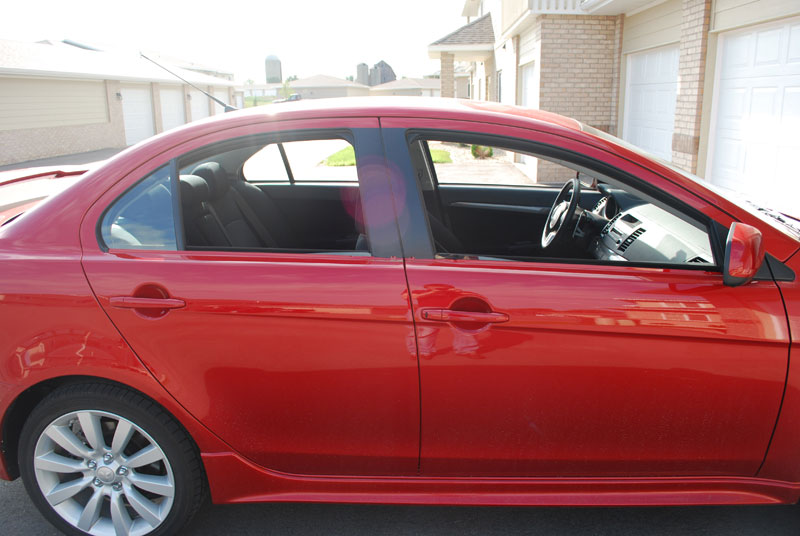

You need to apply firm pressure when trying to slide the trim horizontally. Once you're able to slide it out about an inch (#1, see pic), then you can start pulling up and wiggling it up and out (#2, see pic). Here's a picture showing which direction each piece of trim needs to be slid, and in what order.
Trim slid out on driver's side front door

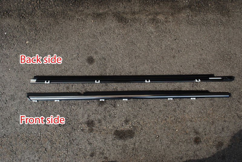

Trim completely removed
Front and back of trim
