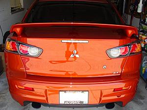

Thanks guys, I forgot I made this thread lol. I took the badges off with just a hair dryier. Came right off with no problems at all, and no goo was left behind at all.
I didnt think I had a good pic of the back after I took the badges off but after some searching around I found this one. What do you guys think?

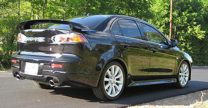

If you do it when the car is new, then you can just pull the emblems off and rub the remaining glueish stuff off with your thumb.
I didn't need floss, a hair dryer, or even goo gone, but had it handy.
Looks good though... Remove the too!
Here is mine, done two weeks ago.

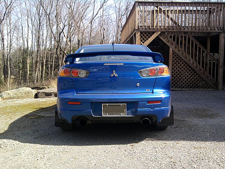

I used a blow drier fishing line and "ronsonol" brand zippo fliud worked like a charm. Make sure you clean and wax the spots where the "badges" were right after you finish. The ronsonol will not damage the paint. Enjoy!
