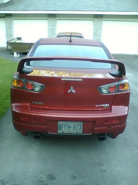

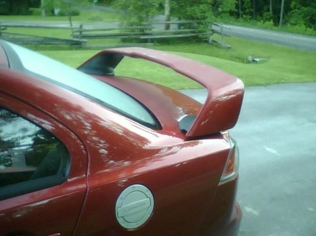

When you pop your trunk and raise, you'll see two bolts on either side of the trunk. These hold the OEM wing on. When you remove the bolts, the wing will just pop off. There is some two sided tape underneath, but that isn't an issue. Now you'll be looking at the trunk with two empty holes on either side. To attach the SSS wing, drill out the two holes that allign with the bottom of the SSS mount. They are easy to find, you'll see two layers of metal, and immediately below the pre-drilled holes there is an obvious place to drill the hole. Drop the SSS wing on, and fasten it using only 2 bolts on either side. This will hold up just fine.
The attached pictures are of my Ralliart with the SSS wing installed.
