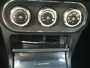

Thanks for that link! Taking the CD head unit out is exactly what I needed to gain access to the back of cubbie. From the rear of the RCA/AUX input, you need to squeeze the top and bottom of the unit, and then it can be pushed through the front of the cubbie. Remove the small wiring clip, then reattach the clip with the RCA/AUX behind the cubbie. I used electrical tape to secure the RCA/AUX unit to some other wiring harnesses below the CD deck so it is now out of sight.
Removing the Air Bag/Hazard unit is not necessary by the way. It was as easy (and scary) removing the carbon fiber and CD face as mentioned in the thread.
Mine doesn’t look pretty yet, as I have to figure out how to fabricate a custom piece of plastic to cover the gap where the AUX input use to be. I’ll post another pic when I clean up the gap. But for now, as seen in my pic, I can close my cubbie door with my iPod connected.
