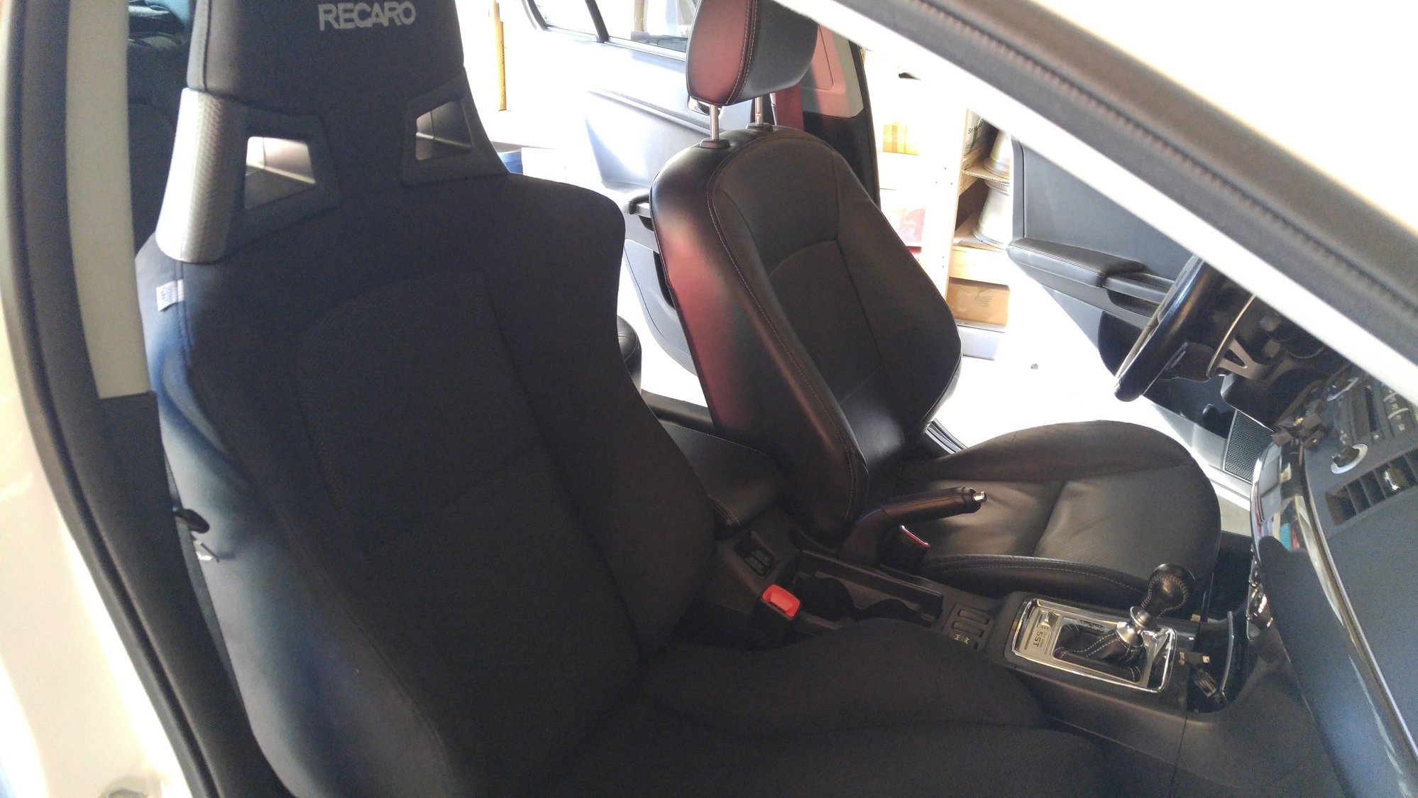

I just did the swap last weekend. My Ralliart sportback is a 2011, seats came from a 2012 GSR.
My seats came with all of their mounts (other than the passenger weight sensors).

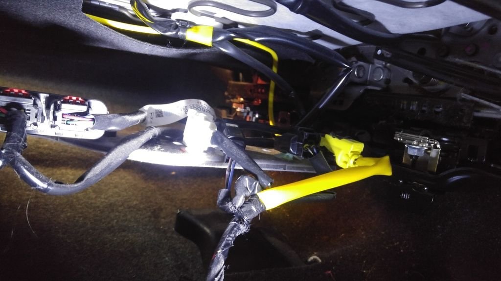

2. Started with passenger side seat, removed plastic and 4 bolts that bolt seat to floor, this gave me room to disconnect all connections under seat.

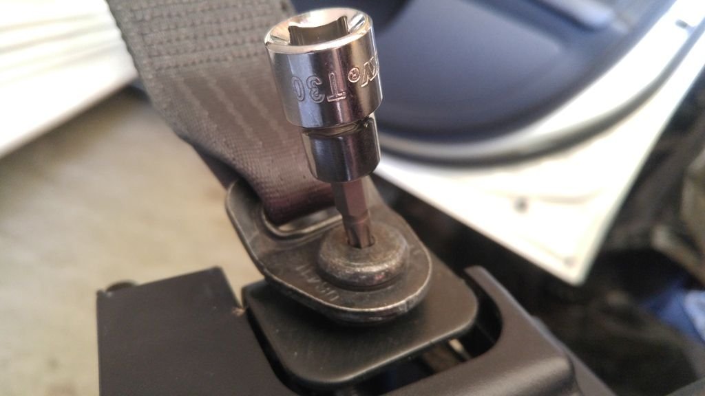

3. pulled out seat but still tethered to passenger side seat-belt lower mount. used T30 torque to disconnect this. and lay seat on it's side.

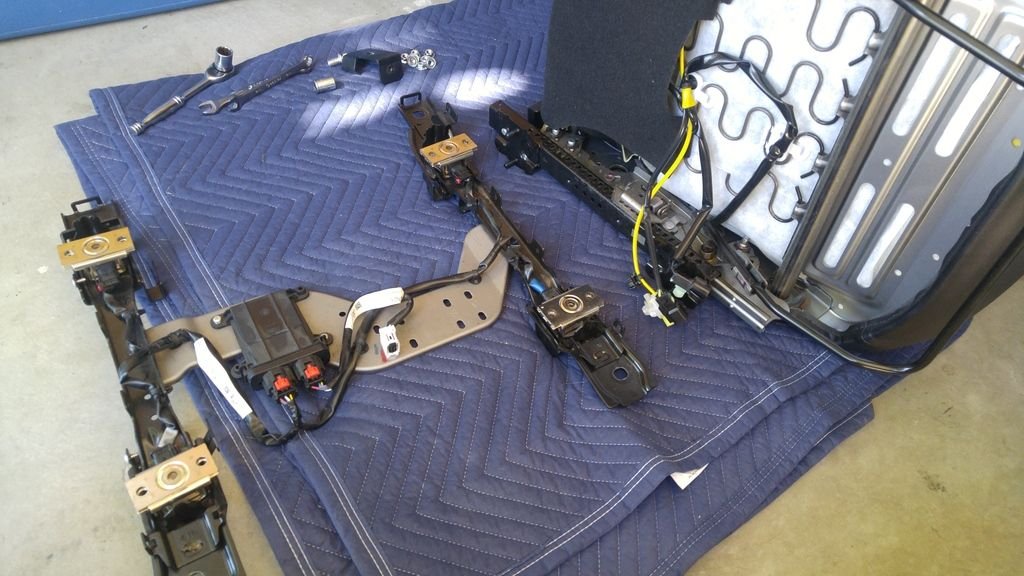

4. Unbolt the 8 weight sensor bolts and rear seat-belt mount bracket bolt. The whole bottom mount with sensors transfers over to the Recaros.
5. Unbolt the seat-belt buckle (17mm) then unzip and pull seat-belt buckle connector.
6. If your Recaro's came with their bottom bracket then remove it the same way. If it only came with sliders then your ready to install your lancer bottom bracket with the four weight sensors to the Recaro's, make sure the seat-belt bracket in the rear and seat-belt buckle are swapped over as well (reverse order of above steps to reinstall). also make sure all other sensors are snapped back into the lower bracket (airbag, seat belt buckle, and heat (if applies to your recaros).
