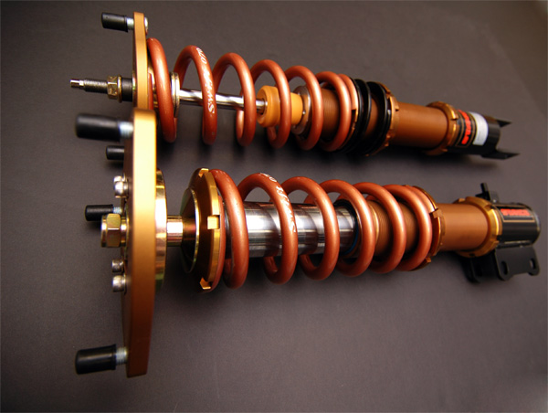

Originally Posted by Touge Factory
hello,
We Have been getting a good amount of inquiries for this combination, and received good feedback from the locals here that have been running this setup on the STANCE SS-D coilovers.
If you are running R-comps on your cars or have a very aggressive setup, STANCE SS-D's with 12k/12k Swift springs might be your best bet.
The SS-D's are valved to accommodate such high spring rates.
Oh did I mention the rears are shy of 10 pounds!!!!!!!!
Are those the SS-D setup? They are beautiful. I don't run R comps though I run RE01R street tires. I usually run in an STU class but want something I can still daily somewhat comfortable. If you could set me up with a price on your aluminum ones 10k F&R with Swift springs like the OP has I would much appreciate it.

The picture above are the STANCE AL+ Pro with Swift Springs.
AL+ Pro with SS-D valving is Special order.

You mean the GR+ Pro's....
AL+ Pro's are GREAT for daily. Solid Aluminum body resists corrosion...and seeing that you're in Washington, this is a huge PLUS!
Depending on what spring rates you want, these are EXCELLENT for daily and great for track events. The valving has been set with Daily drivers in mind, so that it is not overkill on the streets, but can definitely handle whatever you throw at it on the track.
For the drivers who need more aggressive valving for the R-comps we have the STANCE SS-D's. These are not intended for daily or street.
The SS-D spring rates are setup as: 12k front / 14k rear
