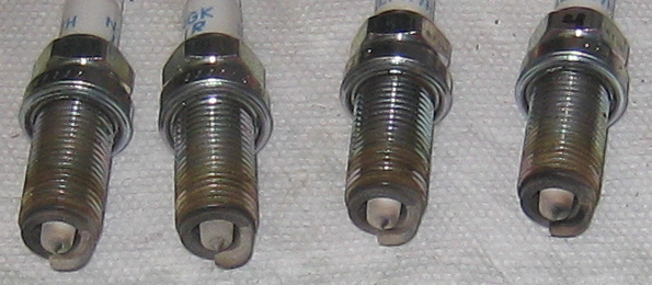

plugs
Here's a picture of the plugs. All except #4 are a very light color, almost white. There is a speckle texture on the ground strap and on the exposed areas of the insulator. It doesn't appear to be erosion but instead a thin buildup of something. The texture almost exactly matches an earlier picture of my plugs when I was running gasoline. I also peaked into the cylinders. What little I could see of the top of the pistons looked perfect. I could easily see the machining marks on the top of the pistons. No erosion of any sharp edged surfaces on the pistons. I think I may buy a cheap fiber optic for this sort of thing in the future.
plugs after many (~20) WOT 13:1 AFR runs
plugs after ~10k miles on gasoline with typical WOT 11:1 AFR
Attached Thumbnails E85 - 13:1 (gasoline AFR) - ACK!-img_3233.jpg

mrfred, can you see the blue/discolored strip on the straps at all? I can't tell where they are by the photo. Although 3 and 4 look like they are right in the middle of the strap which is totally perfect.
Look pretty good overall. How many miles?
