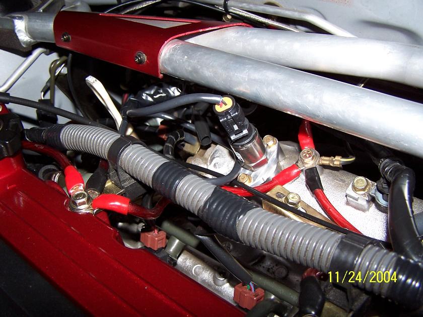

Will do, everyone here is a pic of the MAP adapter installed on my car with a perfect fit in place of the stock MDP sensor. No drilling no cutting

Looks like it puts the sensor pretty close to the strut bar. Is it just the picture or does it really sit that close?
No it just looks close in the pic it is actually under the strut bar and in front both so it has plenty of clearance.
