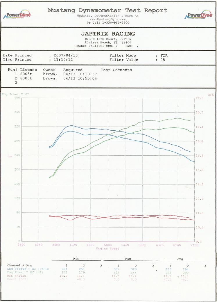

I told Mase I wasn't trying to extract every bit of horsepower out of the car as it's my daily driver. I'd rather have it run good for a long time every day than risk detonation from some bad gas or an extra hot and humid south Florida day. All tuning was done on 92-octane pump gas and I never ran more than 20psi. My highest peak HP was right at 350, but he pulled a little timing at the end to play it safe, which is the graph that is shown.
Here are the results:
As you can see the before and after dynos are only 45 minutes apart. He really knows his stuff and can whip through a tune really easy. When all was said and done, I gained 26whp and 16wtq peak and an average of 16whp and 18wtq! Plus my AFR's are much flatter and still conservative (<11.5) My car runs GREAT now and rips through every gear, AND WITH LESS KNOCK!

Numbers look good. Why do you think boost comp is not good for everyday driving?
