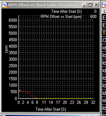

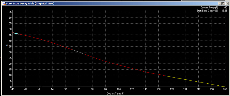

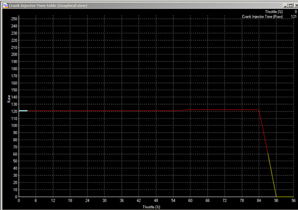

Who is tuning your car??? I was having problems with the cold as well but you need to play with the cold start tables. This is on a IX with FIC 750cc injectors
What helped me is bumping up the "RPM offset vs start table".
Adjust the "crank injector time table". I had the raw at 50 and moved it up to 120
Play with "start extra decay table" by adding some fuel.
Try this and see if it helps. There are allot of other fact that will affect you cold start but this should help.

Originally Posted by awdboosted
Did what I give you help??
Yes it was a great start, Thanks!
