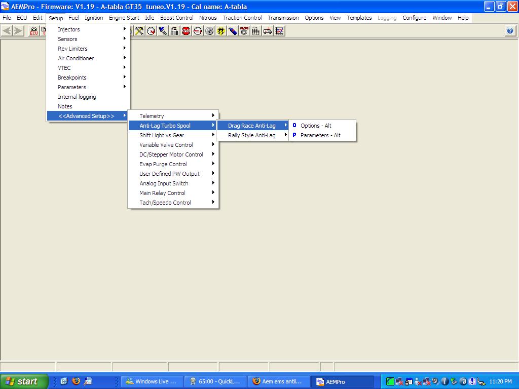

Is there a functionall ALS in the aem ems , i not looking for NLTS i talk about lit off throtle and keep the turbo spool up.

Are you looking for this ?

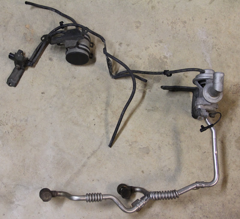

I actually have the full ALS for the EVO IV. Tapped manifold, plumbing, solenoid. All you'd have to do physically for it to work is weld a bung on your UICP to attach the feed hose.
I haven't seen anyone get it to work on stock ECU, but AEM has enough programmable outputs that I can damn near guarantee you can get it to work.
Basically you would set an output so that if RPM is above X and TPS is below X volts, you would set the output to turn on. This would open the solenoid and allow the air to escape via the ALS instead of your BOV.
The manifold is currently on my car, but I'd be willing to let it go at the right price so I can finish up my 6262 setup.

Originally Posted by browningderek
Where can we see one of these setups and how it
works?
This is the basic system, solenoid and some kind of filter canister, the inlet from the piping, and the injectors into the exhaust bungs.
Close up of the valve
closeup of the valve/canister. This was located on the underside brace of the intake mani.
I just kinda placed it on my setup to give you a rough idea of how it sits. Of course the valve is supposed to be a bit lower.

Oh, I see. Its like an EGR valve and just uses the solonoid to actuate it. Im not sure what you would need the vac. canister for.....
So now for the most important question, does it work? Anyone with any datalogs with a comparison on and off?
This setup will work will the aem for sure.

I didn't need any extra parts. You just enable the anti-lag and set your parameters up.
