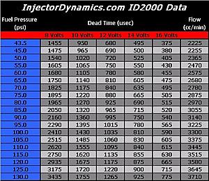

Im going to be tuning a car in a few weeks with a ID 2000 injectors. Can someone stear me in the right direction for the batter offset table? Or is there an injector in the battery offset wizard that is close? Ive not yet worked with high impedence injectors so do I need to do something different with the driver box? Thanks for the help!

I have it posted in the ECUflash forum, it also comes with the injectors.

Here it is :

Thanks a lot!!
