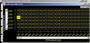

This can't be my fuel map can it?
After hooking my laptop up to the serial cable and turning the car on but not igniting it i went to fuel>fuel map>table and this is what I got. This can't be right can it. What is the proper way to get a fuel map. Sorry for all the dumb questions Im new to this.
