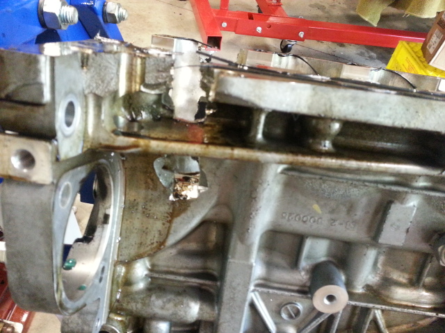

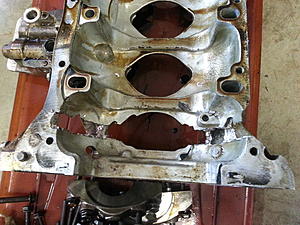

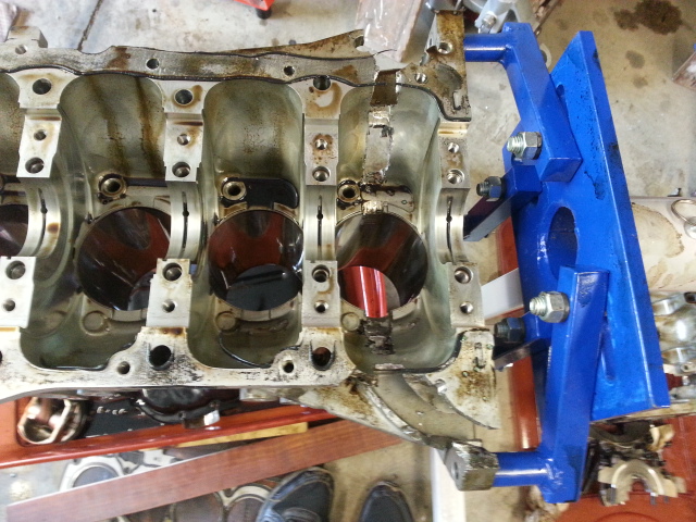

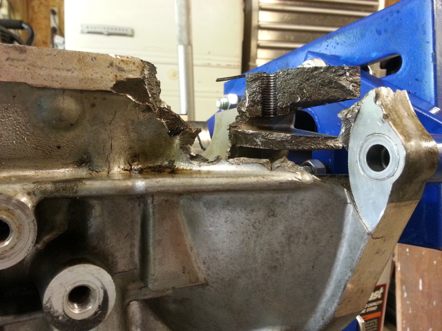

A friendly drag with my buddy's 70 Charger R/T Hemi 4 speed and me on Thanksgiving day resulted in what sounded under my hood like a cage of pissed off pidgeons escaping, the smell of oil, and a Christmas tree of instrument panel lights. Onlookers said I wasn't even running that hard.
Currently I have one of the 2 best EVO builders getting a kit together to get me running again. I'll reveal exactly who in a few weeks. My winter project of pistons and rods turned into a quarter of what the car cost me.
I don't know. Support after a sale always meant something. CBRD falls way short on this area. Perhaps some time off of the flat tracks and more hill driving would give them a well needed clue.
Thanks for reading this. And yes, I'm extremely pissed off. I never, ever blew up and engine before. And all of the cars they were in were badass. My crank is saved. So I can get some bucks for that. The trigger wheel is toast though.
