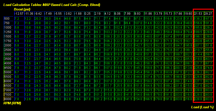

The COBB OTS maps scale 21 to 29 psi in 1 column.
I'm thinking this might be the issue of over boosting possibly as the ECU is just throwing random numbers in there between those 2 values?
I tried to make it as linear as possible, if anyone feels up to contributing please let me know. If you try it out please note any oddities!
Any input from the community would be appreciated!
