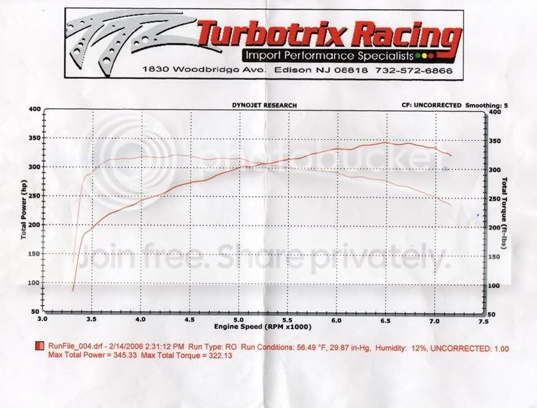

Is this good
Im on the left
Mods:
280 CompCams
TurboTrix Tune (reflashed stock ecu on the dyno)
Greddy Titanium Turbo Back Exhaust
K&N intake cone
TurboXS R34 Purple BOV (discontinued i think)
Hallman Pro MBC (23-22 psi on pump, 29-30 psi on race both taper to 19-20 psi by redline)
255 Walbro Fuel Pump
BPR8ES NGK Spark Plugs
Magnecor 8.5MM Spark Plug Wires
Hotchkiss Springs
Numerous T-Bolt Clamps for the intercooler pipes(but stock pipes and intercooler)
ACT clutch
Fidanza flywheel
Braided clutch line
Clutch restrictor removed
B&M short throw shifter(that thing got to go any evos that want to trade for a stock shifter im down)
Megan Racing Boost Gauge
Megan Racing Oil Pressure Gauge
Megan Racing Air Fuel Gauge
Apexi Turbo Timer
Bald *** continental conti extremecontact all season tires
Cracked windshield

It's just a mis-print. That should be a 7.81, not a 7.41.
The driving isn't bad, just a little slow on the shifting. The mph is really nice for pump gas and is only a few mph off from what the dynograph says. You have a decently fast car.
